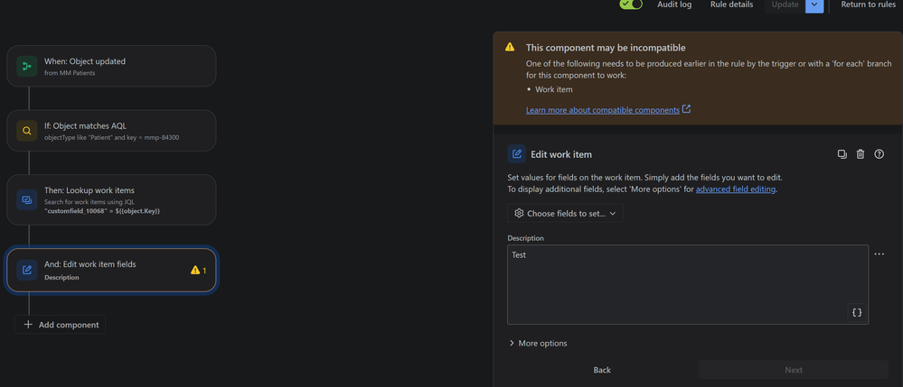

Hello @JEFFREY SCHNEIDER
you could try something like this
Trigger "Object Updated"

@Raphael Lopes
How does this update the fields in the issues that reference the object?

Hi @Trudy Claspill
Great question — triggering "Object Updated" in Assets only starts the automation at the object level. To update fields in Jira issues that reference that object, you need to search for linked issues and apply actions to them.
Here’s how to do it:
  • Use "Lookup Issues" action (Assets-aware)
    After the "Object Updated" trigger, add a "Lookup Issues" action.
  • Use AQL or JQL to find issues referencing the updated object. For example:
    "Asset Field" = ${object.key}
Then add an action like "Edit issue" or "Comment on issue" and use smart values like ${object.Attributes} to reference updated fields.
Example use case:
  • Trigger: Object in "Employees" schema is updated
  • Lookup: All issues where "Employee Asset" = ${object.key}
  • Action: Update a custom field or comment to show the new value
Let me know if you'd like help setting up the exact AQL/JQL based on your schema.
