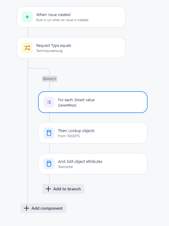

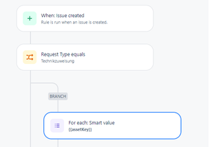

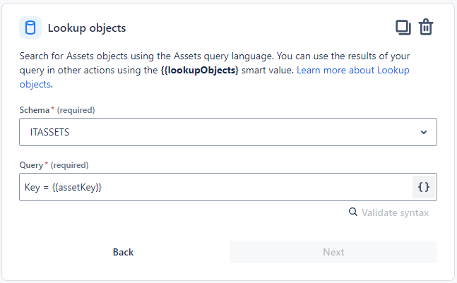

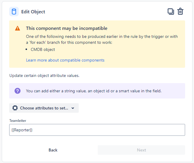

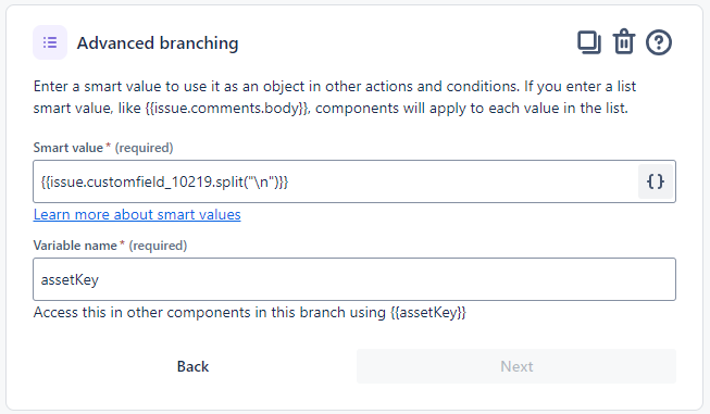

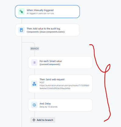

My automation rule looks like this
So from my understanding, this advanced branching should handle every line within the list seperately and for each assetKey in the list, lookup that object and edit my attribute to the issues reporter.

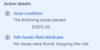

The audit log looks like this
Does anyone has a tip for me how to handle this correctly?

2 things to note (as per the documentation): https://support.atlassian.com/cloud-automation/docs/jira-automation-actions/#Edit-object
1. To use the Edit Object action, you need to use the AQL branching.
2. It won't work with the Lookup objects action

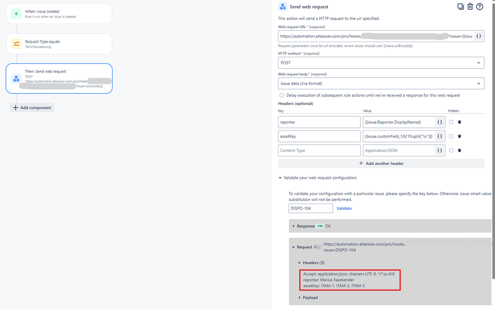

The first rule is handing over the correct values in the headers:

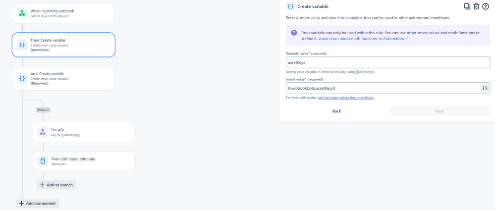

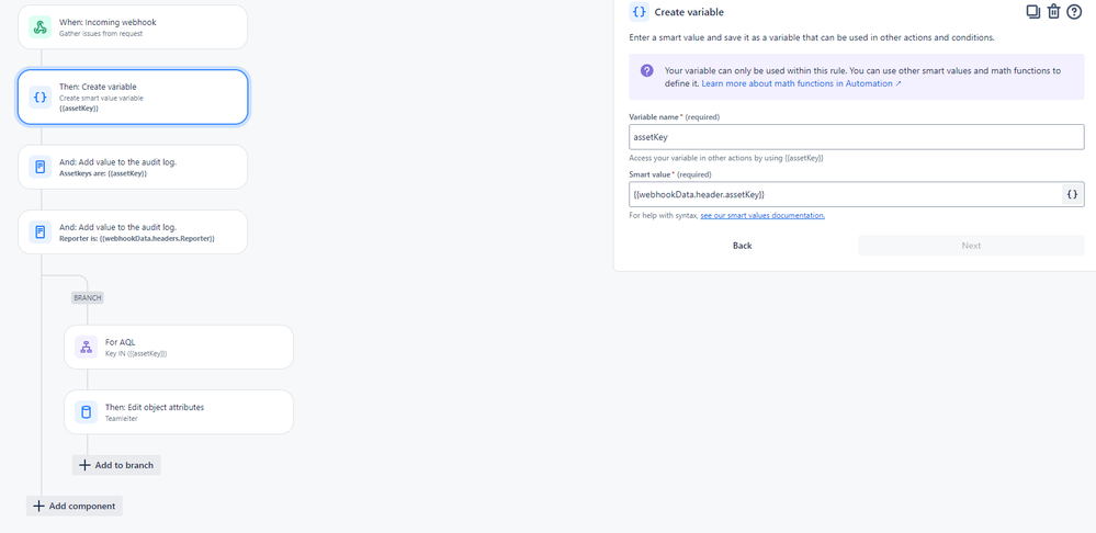

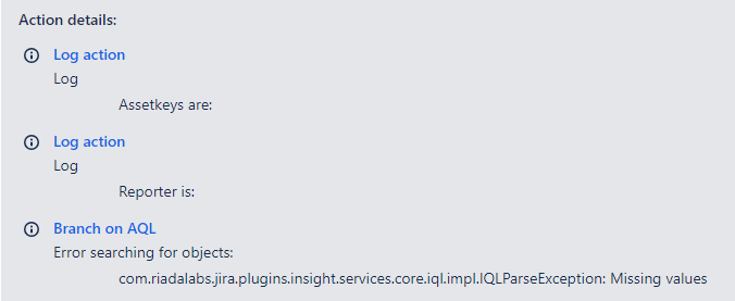

In the second Automation Rule, i tried to refer to them with
{{webResponse.headers.assetKey}},
{{webhookData.headers.assetKey}},
{{webhookData.header.assetKey}},
{{webhookData.assetKey}}
I added those variables to the log within the second Automation Rule to see if they have a value but unfortunately they stay empty:Screenshot 2024-10-28 112745.png
Jehan Bhathena
October 28, 2024
Hi @Marius Fassbender

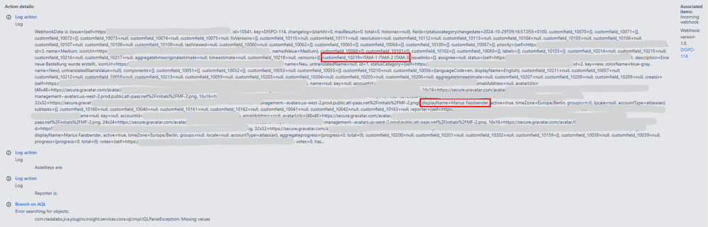

In the "Log Action" try printing {{webhookData}} directly, this will show you the complete JSON data that is being sent to the other automation. Please can share that here once printed, will be able to help with the syntax then. :-)

Marius Fassbender October 29, 2024
Here is the {{webhookData}} Output:Screenshot 2024-10-29 091755.png
As webhookData.headers didn't work, I now tried {{webhookData.fields.customfield_10219}} / {{webhookData.customfield_10219}} as assetKeys and {{webhookData.displayName}} / {{webhookData.fields.displayName}} / {{webhookData.fields.reporter}} as Reporter but my variables are still empty.
Like Jehan Bhathena likes this

The output in the Log Action has been trimmed, due to it's length.

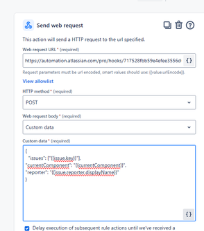

What I would suggest to change in your original automation, is to trigger a Web Request for each asset available(1), and change the request body to "Web request body" to Custom(2). Adding attachments below:
In the Custom body send only the CURRENT assetID, this Asset ID can then be used in the next automation, as reference to a AQL branch which should make your "Edit Object" action work correctly.
Sending my values as custom data did the trick. I can refer those now as {{webhookData.*Custom data*}} in my 2nd automation so it finally works now.
I still send all the Asset-ID's from my custom field at once, but with the Branch AQL statement "IN" for going through all those ID's it works.
Thank you very much @Jehan Bhathena for helping me out with that!! :-)
