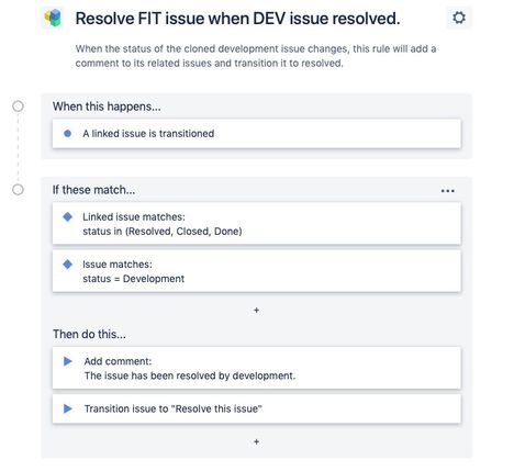

Jack Brickey
November 8, 2018
this should be relatively straightforward. Here is something I use in my instance...

Jack Brickey
June 18, 2020
if by remote you mean a link to an issue in another project, yes it does. I use it between my JSD project and JSW projects. Note, things have changed a bit since this post and Cloud users have two sources (combined into one in the future) of Automation: "Automation" (which this post was referencing) and Project Automation (which is the acquired Automation for Jira). So you have two methods of having the JSD issue updated when the JSW issue is transitioned.
