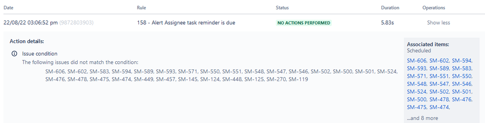

What does the log show when the rule is triggered?,

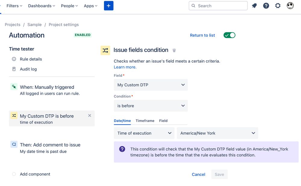

Can you use the issue field condition as below?
