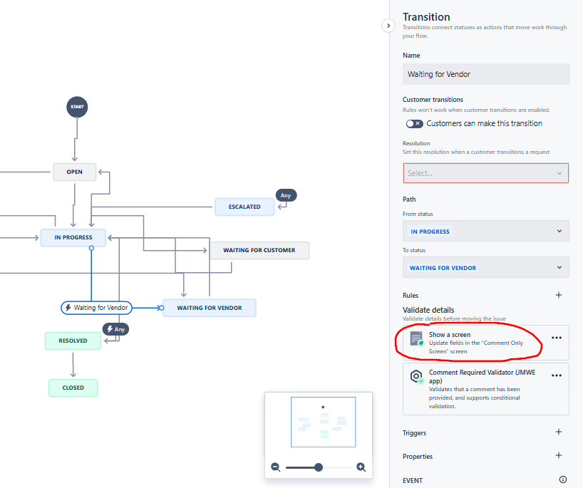

Christopher Yen
May 14, 2025
Hi @cynthiapaola.murillosalazar
Welcome to the community!
This should be doable within the transition between the two statuses in the workflow. In my example workflow below we do have a comment required validator but I believe this is from a marketplace app (Jira Misc Workflow Extensions (JMWE)) and may not be available out of the box, but without the app I think this can also be accomplished with a screen and a custom field and then a field required validator to capture the transition reason. 2025-05-14 09_44_20-Window.png
