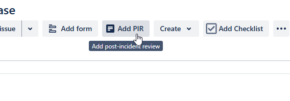

It's been a little difficult for me to get Problem correctly adopted according to ITIL standards within JSM for my users. Common feedback is why do I need to fill out a PIR and then another record for Problem with the same info? I've had some success combining RCA into the out of the box Post Incident Review issue type, and showing users how to draft a PIR using Atlassian Intelligence from an incident which has gained some adoption. With this it's easier to just show our users to use the built-in "Add PIR" button on incidents 2025-05-29 14_36_41-[SD-50385] Jira Association not pulling on SalesForce Case - Jira.png
We then just added fields and processes for long term fix planning, root cause analysis, lessons learned into the PIR object, still pains me that it's all jumbled together but the results and process adoption are what's important. I wish I could rename PIRs in JSM since we've combined problems into it and not all problems require an incident to exist.
