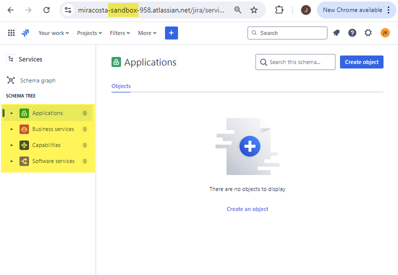

Working in our Sandbox environment, we are attempting to set up the Service Management project. Pages 65-66 from 'IT Asset and Service Configuration Management in Jira Service Management' document shows how the default, read-only object schema named "Services" is supposed to be set. This is set up correctly (according to the document) in our Production environment but not in Sandbox.
The 'Services (SVC)' object schema should have a single Object Type with a single Object. This is correct in Production.
In Sandbox, there are 4 Object Types (not including 'Service') with no Objects.
JSM_Sandbox_Services_Schema_2024-08-12_13-38-30.pngJSM_Sandbox_Services_Schema_Missing_2024-08-12_13-39-05.pngJSM_Production_Services_Schema_2024-08-12_13-41-01.png

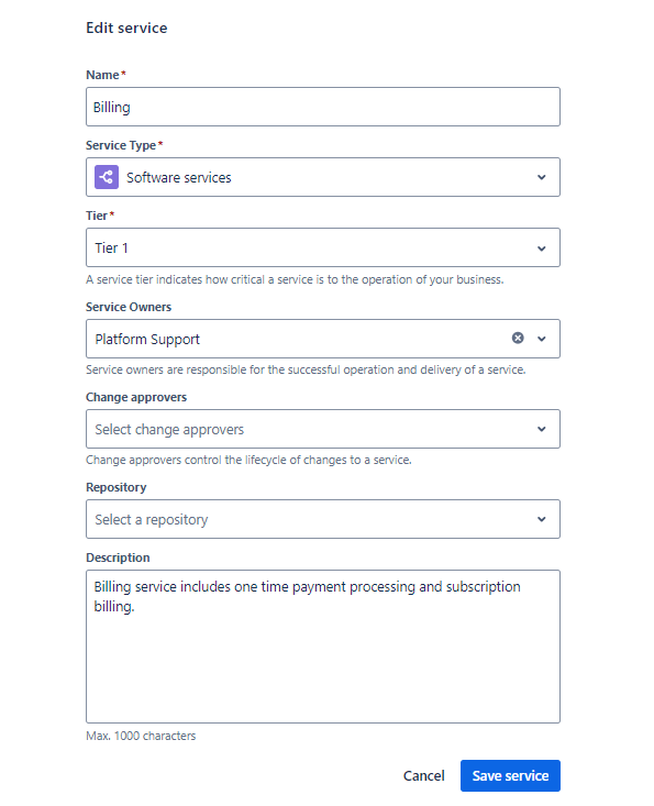

It looks like your Sandbox is ahead of your production environment, in that the 'Services Type' is a relatively new addition to the Services schema.
I believe that the he Services Type is apparently used by Compass, and is currently not available to JSM, even though you need to enter it. So, you can not say, list all Services with Service Type = "Application".
In short, I do not believe there is anything wrong with your Sandbox, its just ahead.

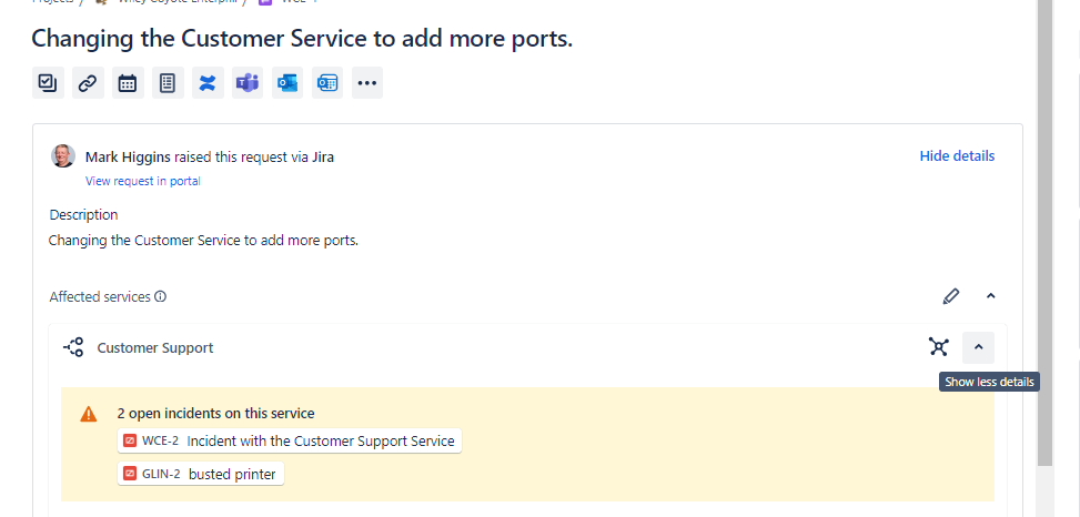

In this example, I have created an Incident and the 'Affected Service' is 'Customer Support'
JSM has natively shown me that there are 2 other open incidents on this Service.
If someone is carrying out a change on the 'Service' then in the issue view you will see:
The warning sign. Click the warning sign, and you will then see:
Other areas you will see this is in the Change calendar.
