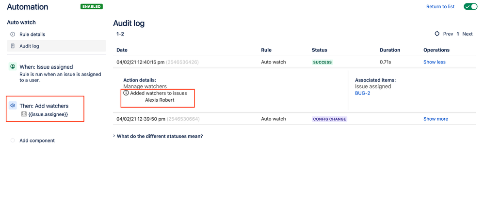

Hi @Alex Koxaras _Relational_ ,
I've just tried it on my test isntance and it looks like it works fine with {{issue.assignee}} as you can see :
I'm not sure if you're describing the same scenario : are you also using the Automation Rule to set the Assignee ?

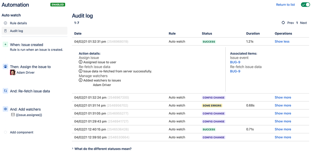

Alexis Robert
February 4, 2021
I have tried again and you're right : it won't work if you have an action to Assign the issue and then use that value for the watcher.
I've how to fix this : you need to add "Re-fetch issue data" between the "Assign" and "Add watcher" steps :
This way works for me at least.
--Alexis

Jack Brickey
February 4, 2021
Yep this is a know limitation and the refetch is the solution. Or you can break the rule into two rules.
February 4, 2021
Hi Alexis!
That did the trick! The force is strong with you (Adam Driver got me laughing so hard)!
Thank you for trying solving this problem. When you actually select the re-fetch data, it actually stated when this should be used.
Insightful!
