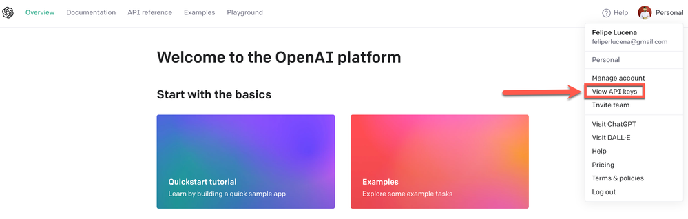

The first thing you need to connect with the OpenAI API is an authentication token, and you can do that by following the steps below:
  1. Go to OpenAI's official website: https://openai.com/
  2. Create an account (if you don't already have one).
  3. Then, authenticate with your username on the Platform page, click on your username (upper right corner), and go to the option View API Keys:
openai_view_keys.png      4. This page will display all the keys associated with your account. In this step, click on “Create new secret key” to create a new API key.

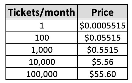

See the table below for how much the monthly amount would be to automatically sort Jira tickets through ChatGPT:
Incredible, isn't it? With a volume of 10,000 tickets/month in your Service Desk, the investment is a mere $5.56 USD to sort them all! An unmissable opportunity to optimize your operation!
But how did I arrive at this value? Let's dive into the details.

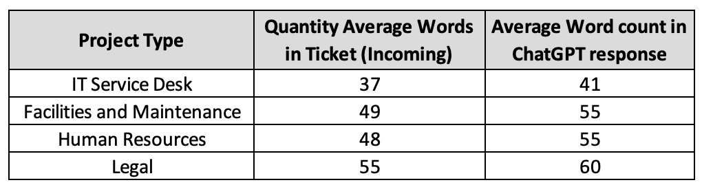

To determine how many tokens the ChatGPT API might need when processing messages, I analyzed several databases in Jira Service Management. The objective was to identify the average number of words per ticket, considering different types of projects. The following table shows the average number of words in both the original ticket (input) and the response generated by ChatGPT:
Based on the average number of words per project type, we can calculate the estimated amount of tokens that the ChatGPT API will need to process the messages. The formula for this estimate is:
Tokens (Input) = ([Number of Base Prompt Words] + [Number of Words by Project Type]) * [Language Factor].
ℹ️ Note: "Prompt Base" has a total of 153 words. You can check the full content of this prompt at this link.
Tokens (Response) = [Number of Words in ChatGPT response] * [Language Factor]
For example, for a Servide Desk IT project in English, it would be:
  • Tokens (Input) = (153 words + 37 words) x 1.5 =~ 285 tokens.
  • Tokens (Answer) = 41 x 1.5 =~ 62 tokens.
Now, with the total number of tokens for input and response, we can calculate the cost using OpenAI pricing for ChatGPT 3.5 Turbo:
  • Entry Price (input) = Entry Tokens / 1000 x $0.0015
  • Response Price (output) = Response Tokens / 1000 x $0.002
Total cost
Entry = 285 tokens x $0.0015/1000 = $0.0004275
Answer = 62 tokens x $0.002/1000 = $0.000124
Total = $0.0004275 + $0.000124 = $0.0005515
Conclusion:
Based on this estimate, the cost to triage a ticket in an IT Service Desk environment using English is just $0.0005515 per ticket.
