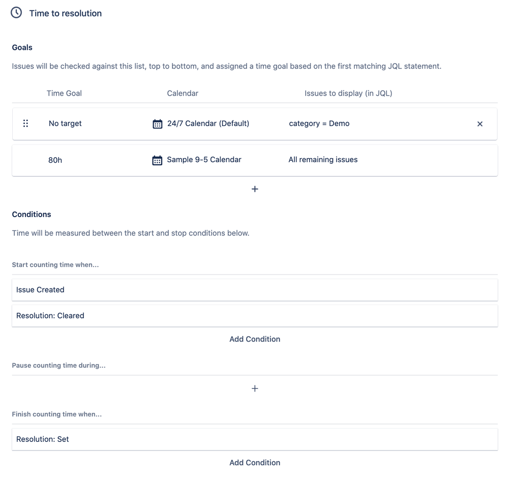

You could try to work with 2 different SLA calendars: 1 that runs 24/7 and 1 that runs 06:00-24:00 as you have set up now.
When a ticket is created before 24:00, you could mark it (in priority, in a custom field, ...), so you can easily set up separate JQL criteria in your SLA definitions to apply the correct calendar.

I guess I would look into setting up an automation rule that automatically e.g. checks a box when an issue is created before 24.00. That way you don't have to do anything manually at all and based on the simple check box you can set up different calendars based on that check box.
As you can see in this example, you can apply different calendars within the same SLA:
Your JQL defines the time goal and calendar to use, while the start / stop / pause settings are the same. Just replace the criteria from the above example with the check you need to distinguish between both your workflows.
