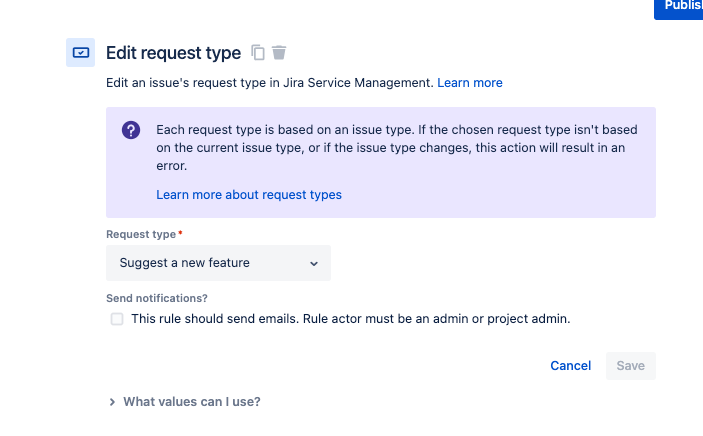

When I use the Clone action in Automation to clone an issue in a JSM project to another JSM project, and I don't call out any additional fields to set, I find that the Request Type field is not copied to the new issue. The Request Type field must be set for the issue to be accessible in the portal.
Note that you can't actually set the Request Type field within the Clone action.

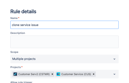

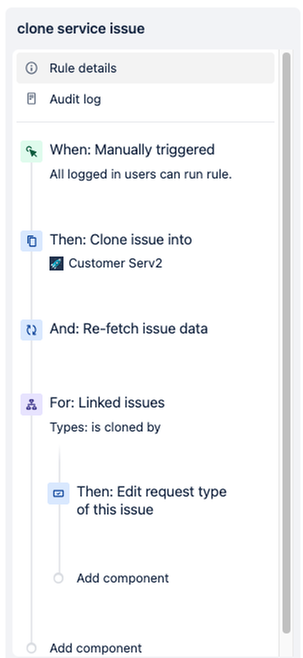

You will have to update your Clone action to create a link ("clones", Trigger issue) between the new issue and the trigger issue. Then you will need to re-fetch the issue data, branch for Linked Issues, and Edit Request Type on the linked issue.
In order to do that your rule will have to be changed from a Single project rule to a multiple project rule naming the source and destination projects. That change can be made only by a Jira Administrator.
