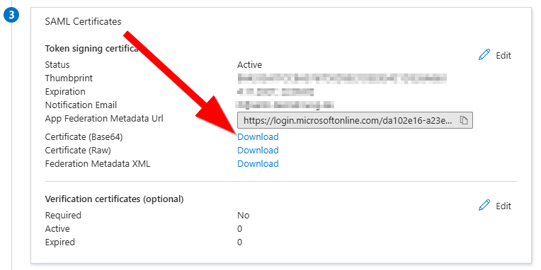

2024-11-11 13_54_44-Attributes & Claims - Microsoft Azure.png In the same page check the SAML Certificates section and download the Base64 version of the certificate:
Make sure to copy it by using a text editor (eg notepad++) and not Word or a tool that might do magic with encoding and paste it here:
2024-11-11 13_07_53-SAML configuration - seitz-tiernahrung - Atlassian Administration.png
Even so I did know that you need to be carful in copying the certificate Base64 encoded and including "BEGIN" and "END...." marks etc. I did obviously a mistake there....
As far as I understand the issue, the SAML authentication works without but the JIT (just in time provisioning) of a new "customer" is only possible if a trusted source (certificate) delivers the customer data....
Hope this solves your issue as well...
