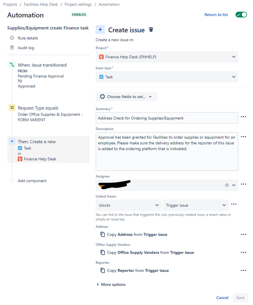

  4. Automation triggers to perform the following actions:
    • Create a task issue in the Finance project.
    • Set specific fields

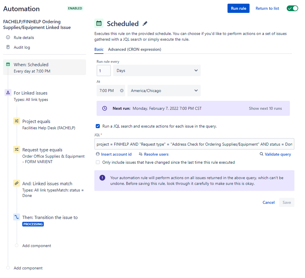

  7. Global Automation triggers once a day to perform the following actions:
    • Check Facilities issues for their subtasks. If the subtasks are Done, transition the issue to the next status.
Step 4 Details:
After reading a few other community questions and checking the available automation options. I found the options to create issues in other projects. The automation creates the issue, but some of the fields are not working.
I checked the field configuration that the Finance project issues use and confirmed the custom fields that failed are in that field configuration. So not sure what else might need to be done on that. The fact that just linking the issues isn't working properly is also discerning.

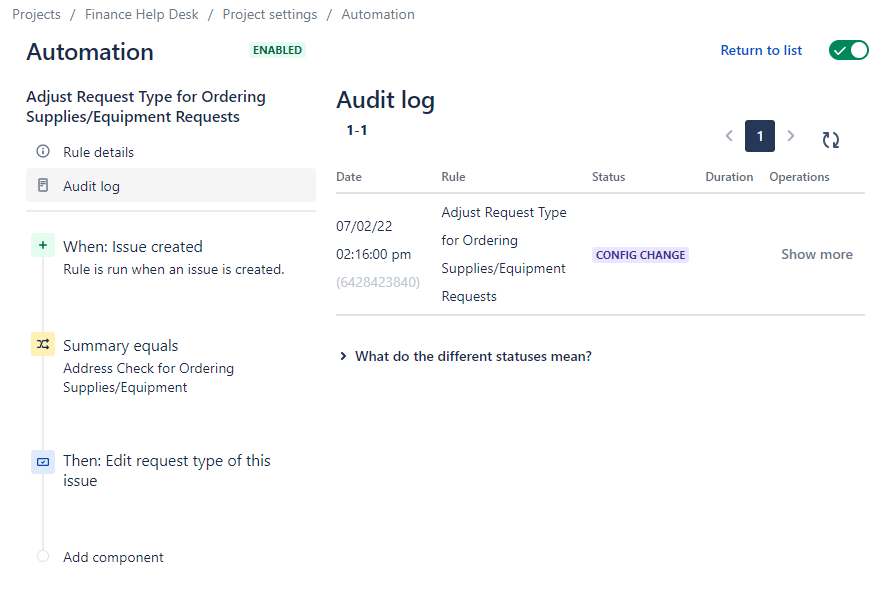

Step 5 Details:
After the Facilities automation creates the Finance issue, we have automation in the Finance Project to adjust the request type on the task to the request type we prepped for it. But it looks like the trigger of issue create isn't working. I'm guessing an issue created from other automation doesn't trigger the "issue created" trigger? Which now that I'm typing this, I guess makes sense to prevent automation loops? If that is the case, can we adjust the request type of that issue in the previous automation or should we use a different trigger?

After reading This Post , I see that we have to make this global automation. We decided to set it to a daily check to keep our runs below limit. I manually ran the rule a few times and no matter what I change, it isn't finding an issue to transition. I have the rule set to both the Finance and Facilities projects.
The thought was that it would run a daily check on Facilities issues of a specific request type and if it has a linked issue that's completed, move the issue to the next status.
This was so that our facilities agents can just watch for the status change and know it's ready for them to work as the other issue has been completed.

  • Unknown fields - I believe they need to be available on the screen config for automation to populate them
  • New Issue Trigger - Verify that Allow Rule Trigger is checked under rule descriptions.  By default, Jira does not enable rules triggering other rules to optimize performance

Thank you for cutting right through the web of everything I was looking at and knowing exactly what the two issues were.
I was initially confused on screen, but then figured you meant the create screen.
Just in case anyone else is reading this for information. I ended up making a specific issue type for this request and then making a specific screen scheme/screens for the new issue type.

I ended up resolving this issue by adjusting some settings back and forth. I found plenty of community posts saying you had to have a global transition to the status you wanted to automate the move to.  Tested that and it was not the case for us.
Looking at all the other settings, I found that we have two "Request type" fields for some reason. I changed from the first in the list to the second and that resolved the issue for us.
