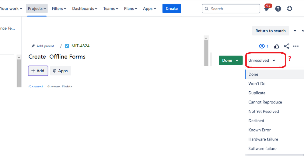

I got very confused to see this RESOLVED tab on the right pane while viewing issue.
Where I can configure and remove it ?
I'm on CMP agile project.
Appreciate you help.
For some other projects I have ACTION tab for the same Jira Cloud instance , upon clicking on it I have pop up <From Automation> without any other details.
is this part of WorkFLow?
THanks
Ratom
What you see next to the Done status is the resolution, this is what tells Jira if the item is closed or not. You should never create/use a resolution called unresolved/none, any issues that has the resolution field set to a value are considered as resolved. You can learn more about best practices using the resolution field in this KB.
The KB mention that you can use a workflow transition to set/change the resolution on existing work items. Another option is to use an automation to do this, that way you do not have to change the workflow.
One more thing to note, any time you add the resolution to a screen it will become a required field, so you should only add it to a screen that is associated with a transition to a done status and the user should be able to pick the resolution.

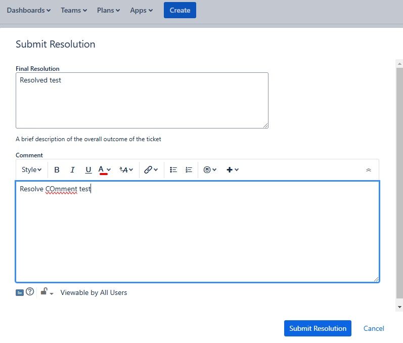

I've tested it, when I set Status = Done, I have popup windows to set resolution like below, I put something into both those fields and do SUBMIYT RESOLUTION and after this I still have it UNRESOLVED.

As outlined in the KB, you should never use Unresolved/None as a resolution. And if you get a screen and select the resolution and it is still set to Unresolved after that then you most likely have a post function on the workflow that sets it. Post functions will aways overrule anything that you select on a screen.

Looking at the attached screenshot you are not selecting the resolution, the field Final Resolution is just a custom field and not associated with Resolution. The resolution field is a single-select dropdown field and would be marked with a red asterisk indicating that it is required. So you should check your workflow for a post funtion.

When user select status = DONE, he gets resolution screen where he type something in 2 windows and click SUBMIT RESOLUTION.
After this Status =DONE, and the right we have NOT YET RESOLVED.
Is it by design to make user select resolution from that drop down ? My users just want to mark it = DONE. I will check all options again

If you do not want the user to select the resolution then remove the resolution field from any screens that the user have access to and then add a post function that sets it. Here is an example of what it looks like in both the old and the new workflow editor.
To supplement what @Mikael Sandberg stated, "Unresolved" is the default internal representation of NULL value for the "Resolution" field"
From the image that you shared, it means that when your issue's status changed to the terminal status (i.e. DONE), your WF transition is not setting the value for the Resolution field at all. This is a problem because, the Resolution field population is always controlled via the WF transition to the terminal status.

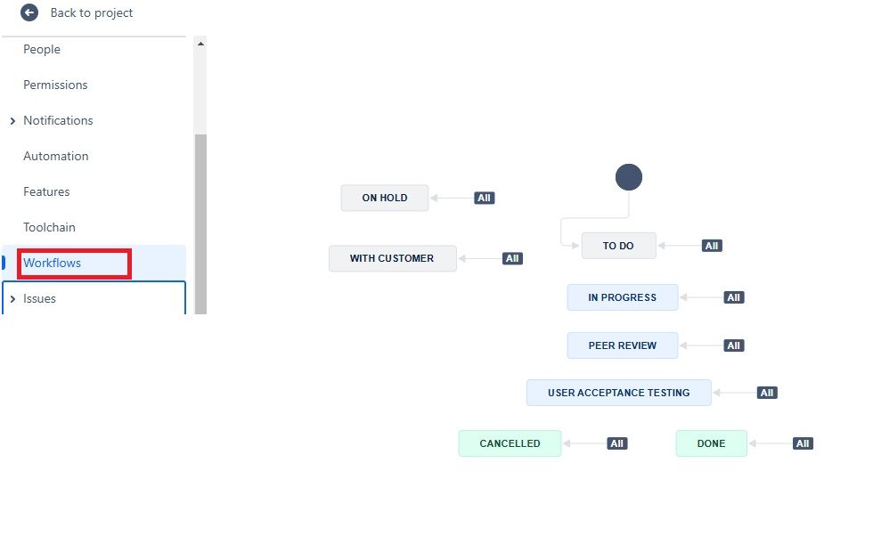

for project in question I have this WF, which is very generic, but I need to learn how to check default value for Resolution. looks very generic.
