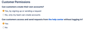

Can tickets be submitted without logging in by just providing an email address?
Yes, you can let your Customer portal public for customers to create tickets without logging in.
First, go to Project Settings > Customer permissions (Classic) or Service Desk settings > Channels > Customer permissions (Next-gen). On this page, select the options below:
After that, go to Cog icon > Products > Configuration and select the option for customers to create their own accounts by signing up or sending a request and also for them to send requests without logging in:
