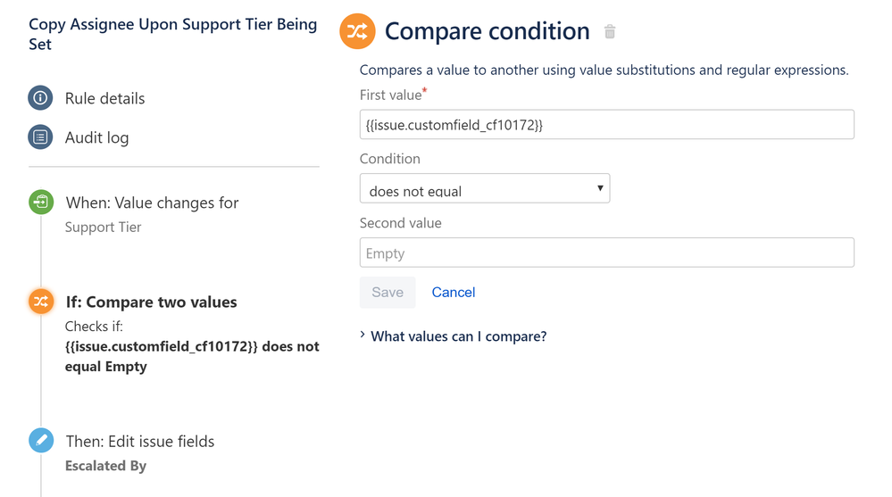

The latter. The support tier custom field is used when our support desk needs to escalate to one of our dev teams. So, I would like to copy the assignee field into the escalated by custom field once that Support tier field is changed from EMPTY to Some value.

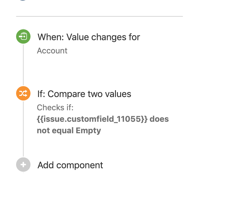

You definitely can't do that with OOTB automation. In AFJ you can though!
Attached is a screenshot to make this easier to understand but you would do the following.
You can skip steps 1 and 2 in the Automation 1 and do these steps instead
  1. Instead of using the trigger, Issue Transitioned you would use Field value changed
  2. You would select the field Support Tier
  3. Then add a compare condition
  4. For the first field, input {{issue.customfield_IDNUMBER}} replace IDNUMBER with the custom field ID
    You can get this ID by going to the custom fields section in Jira Settings < Issues < Custom Fields
    Find the custom field and select Edit
    The ID will be at the end of the URL
  5. Once you have the ID and the first part filled out, set the condition to Does not equal
  6. Leave the second value empty.
  7. Continue with steps 3-7 in automation 1

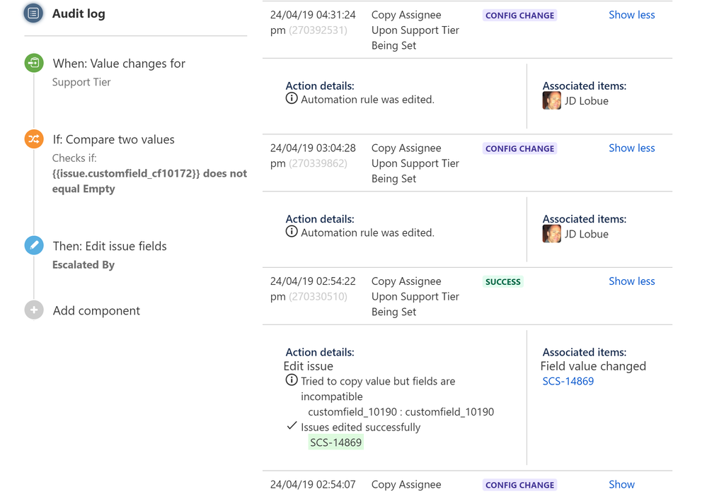

Do I care about the compare values? The tier is not being changed again once development is complete. A new status would trigger the assignee back to the one who set the support tier?
This is what I got in the log for the rule:
Action details:
Edit issue
Tried to copy value but fields are incompatible
customfield_10190 : customfield_10190
Issues edited successfully
Any ideas? The custom field is a user picker for all issue types. I don't have it available on any screens because I want it hidden. Do I need to configure the custom field in any way for compatibilities sake?

The if condition is a failsafe so the automation doesn't accidentally run. I recommend keeping it.
From the error you provided, it looks like the field may have been inputted incorrectly. Do you have it in the below format?
{{issue.customfield_10190}}
If not please change it to that, if you do can you please take a screenshot of the if condition and the audit log?
JD Lobue
April 24, 2019
Cody Stevens
April 24, 2019
Ah, that's your problem! It needs to be exactly {{issue.customfield_10190}}. You have the cf before the number.
JD Lobue
April 24, 2019
I found the error. I had the value pulling from escalated by and not from assignee. Thanks for all your help. What if I want to allow the support tier to be able to move from one escalation dept. to another? Can I change the condition to allow for that?

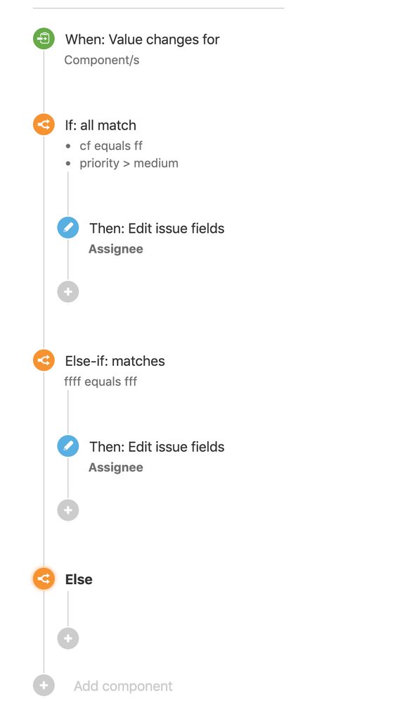

support tier is a custom picker with tier values (Tier 1, Tier 2, Tier 3) and each tier can be used once support escalates. Tier 1 may need to push to Tier 2, and maybe to Tier 3. No user is selected. If support goes to tier 1, a dev in tier 1 is assigned, then changes to tier 2, currently the escalated by is updating to the dev in Tier 1. I need it to stay with the Support engineer who initially escalated to tier 1.
Cody Stevens
April 24, 2019
It can do pretty much anything you can imagine. To achieve that you would use the condition If else Block. You would add the conditions and actions under the first block and you would add a jql saying Support Tier = Tier 1 or a compare condition for {{issue.customfield_10190}} equals Tier 1.
Then add and else and do the same stuff but change the Tier 1 to Tier 2 and then change who the assignee is.
