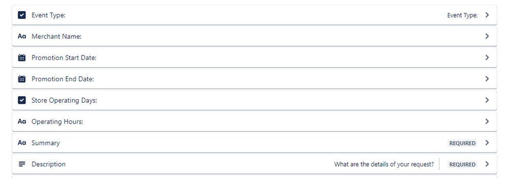

Created a Jira SM project, and set all the fields for the request type and created a form with reactive fields that appear based on other selections.
I am including screen shots below of the set up I have - The issue is the request form link itself in the portal is not even remotely in the right order, even though the other 2 form and request type structure are in the desired order.
Note how event type & promotion Start and end date are not at the top of the actual Portal form.

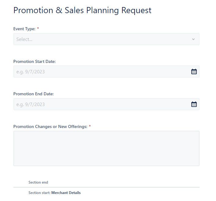

JSM Form Design:

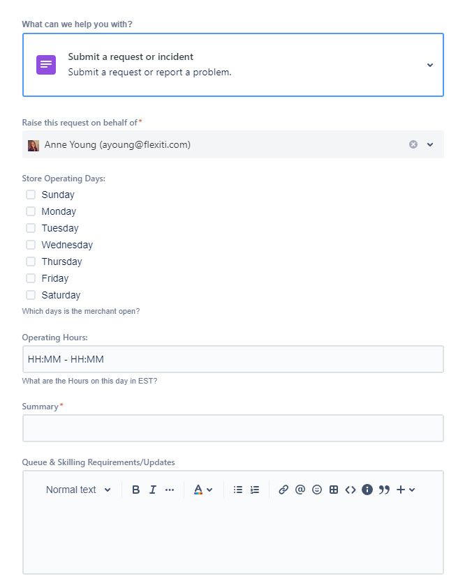

JSM Portal Form presented to customers:
Anyone who can help me fix this so they see the form the way it was designed vs. this random order of fields?

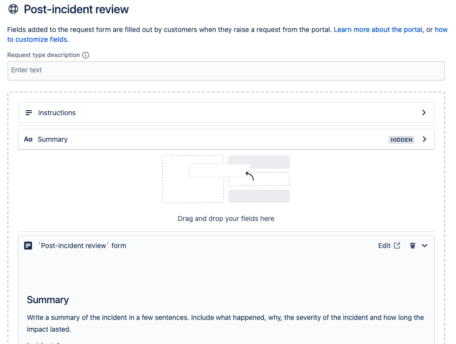

What you see is expected. All the fields in your request form will be displayed before the Form is displayed, so if you only want to display the Form in the portal you have to remove all the fields in the request form and hide the summary field. Something like this:
