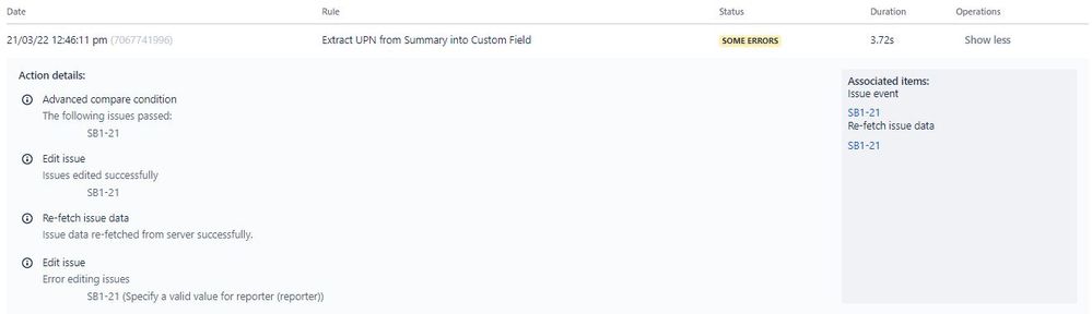

It looks like its not accepting the email as a valid value for the reporter =/
Can you post a screenshot of what you're setting the Reporter to? It's also a good practice to add a "Log action" before editing reporter with the smart value you're setting in the reporter so you can debug / output it value and see what it's setting.
