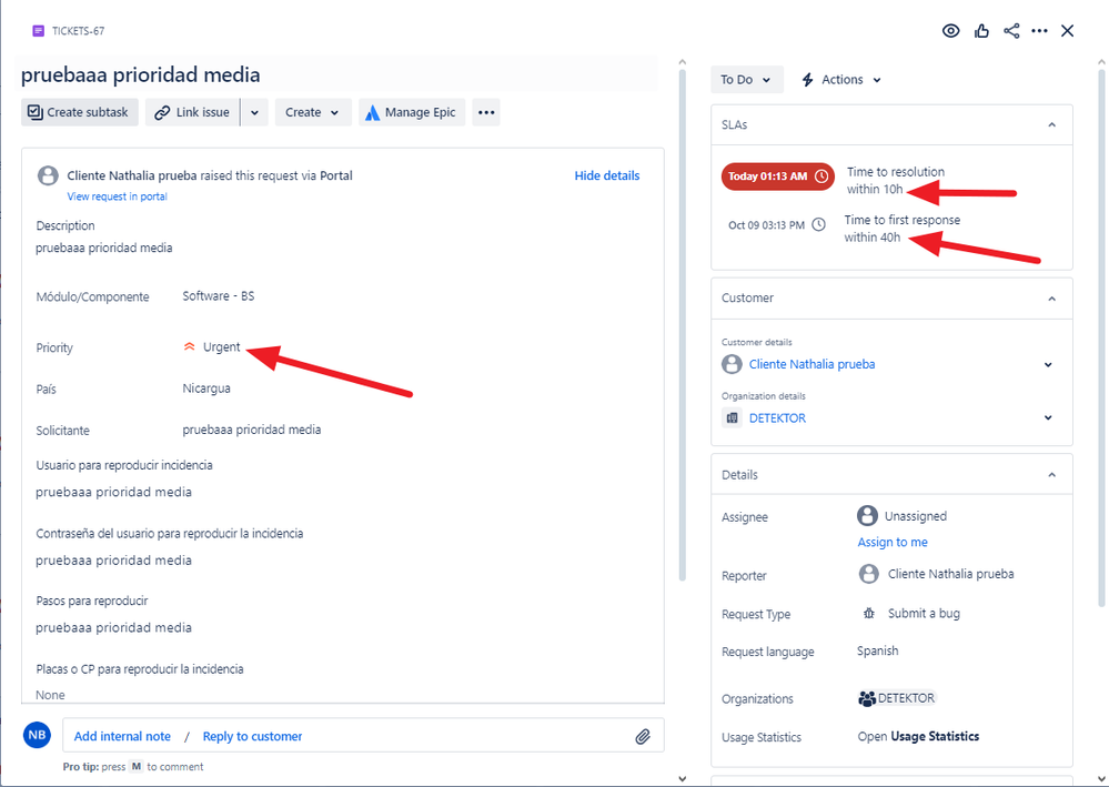

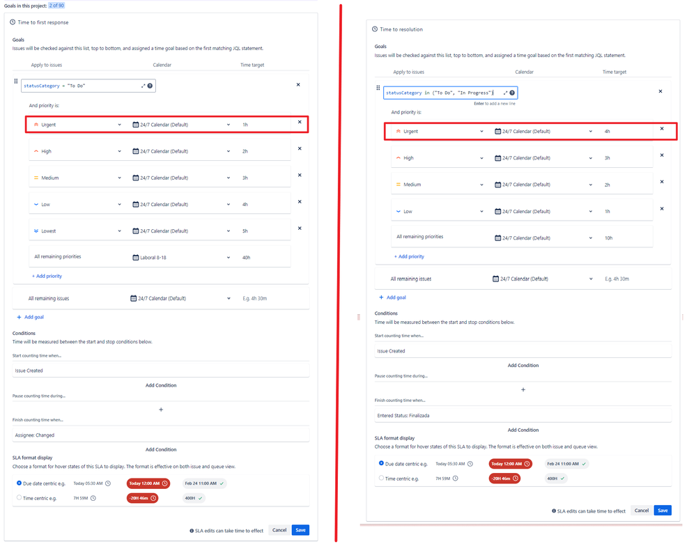

I have configured the times for each priority, but it always takes the time of "All remaining priorities". What am I doing wrong?

Hi @Nathalia Barbosa ,
I highly recommend not to use Status Category as a criteria for the SLA goal.
Your 'Time to Resolution' for example, will start counting on issue creation. And it will finish counting when the status is Finalizada.
However, your goal only applies to issues with statusCategory To Do and In Progress. And as soon as the status is in statusCategory Done, the 'All remaining issues' will apply.
So even if this SLA would work, it wouldn't give you any useful resutls.
So instead, use a JQL such as:
Type in (Incident, 'Service Request')
To determine the scope for the Goal. This way, all Incidents and Service Requests will follow your SLA goals per Priority.

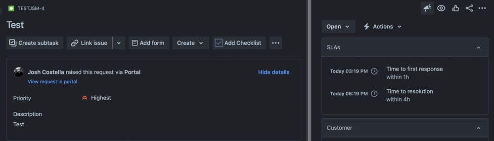

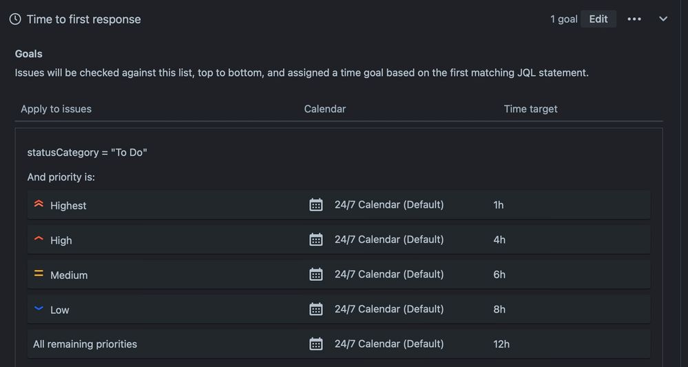

October 4, 2024
I was able to get the SLA to behave as it should. But I agree with @Rod , try to utilize a more consistent data point like Request Type.

I would say that this is normal behavior for how you have configured the SLAs.   Specifically, JSM (nor I) does not think it makes sense to have SLAs configured by dynamic fields like "Status Category".
For a test to convince yourself of where the problem lies, please remove Status Category from the condition (you can put something like issue type instead if you'd like) and then you should see that it picks up the rest of your SLA configuration.
