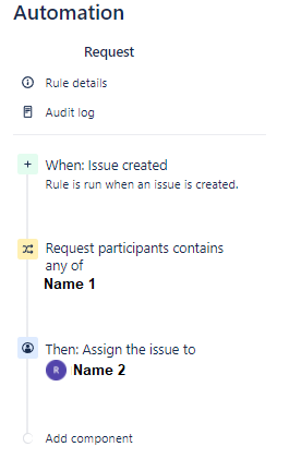

I need to assign the issue to a particular assignee when the issue is created and the "Request participants" field contains a specific email address.
I use simple

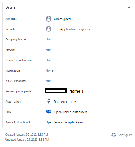

Then I test by sending the email request with "Name 1" in CC, the issue is created, the "Name 1" is in Request Participants:
but the Audit log reports that "The following issues did not match the condition:" and the rule is not applied.
It seems pretty straightforward, so I don't understand what can be the issue here. I tried using the Advanced rule with accountID, etc, and the result is the same.

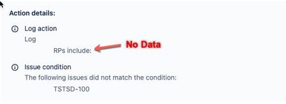

Hi @Alla Austin , one suggestion I would make is to use the "log action" and log the Request Participants info. Do this just after trigger. Then when you test we can see what is in the field. I will try to do a quick test myself when I have a sec.

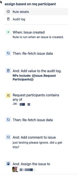

so i did some testing using the below automation. Initially w/o the refetch actions.
Test 1: without the refetch the Assign wasn't happening because the Condition failed as @Alla Austin mentions. Note - looking at the test issue the RP did have the Cc user as well.
Test 2: Based on T1, I theorized that for some reason the RP field was not getting populated at create time before automation triggered. So, without refetch I changed the trigger to be on a Comment. The test was successful and issue assigned as expected.
Test 3: I decided to use the re-fetch data to see if it would address the apparent race-condition. As shown in my automation I added two re-fetch actions, though this is over-kill. The test was successful.
Summary: for some reason the RP data is not added before the automation triggers. I hope to learn why.

Thank you so much! I did re-fetch (right after the trigger "case created"), and it worked. Last night I had a suspicion that for some reason, the PR field was populated after the case was created (even though it makes no sense), but I was so irritated it did not work that I gave up and created a cry for help on here :)
Thank you, @Jack Brickey and @Pramodh M, for responding so fast! I am not an experienced user of Automation and did not know about the re-fetch function. My rule works now. @Jack Brickey thank you for going the extra mile!
