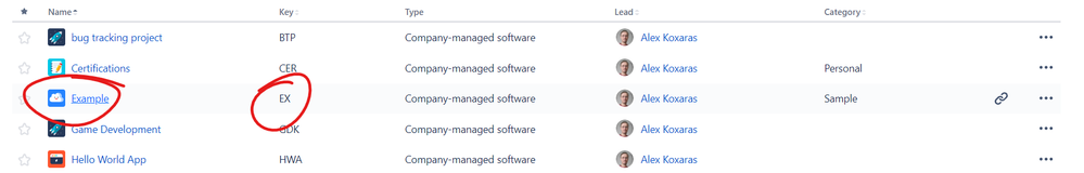

Hi @surya manne
I've successfully managed to create a project via REST API, using the following code, which is suitable for me:
"notificationScheme": 10000,
"description": "Cloud migration initiative",
"url": "https://koxaras.atlassian.net",
"avatarId": 10200,
"issueSecurityScheme": 10000,
"leadAccountId": "5f9fb7c1c2e5390077abf628",
"projectTemplateKey": "com.pyxis.greenhopper.jira:gh-simplified-basic",
"name": "Example",
"permissionScheme": 10000,
"projectTypeKey": "software",
"key": "EX",
"categoryId": 10000
} In the example below, I change the project type to that of a kanban.
