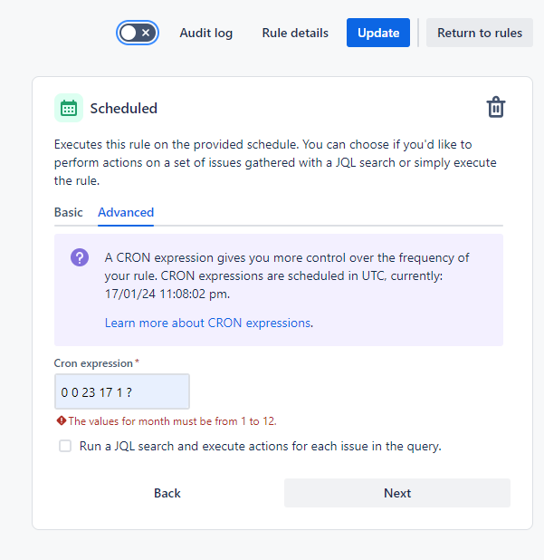

I am trying to run an automation rule on a particular day of the year (in my example it is Jan. 17th). No matter what I do, Jira comes back with the message saying "The values for month must be from 1 to 12". I have tried many different formats, including using JAN as well as leaving the CRON empty, and it still comes up with the same error message, which makes me think it may not be the month that it is complaining about at all.
Here is an example of my CRON statements I have tried.
0 0 23 17 1 ?
As I understand, this should translate to:
second=0
minute=0
hour(UTC)=11pm
day=17
month=1
day of the week=not specified.
Attached is a screenshot of the error. Any suggestions would be greatly appreciated.
I seem to remember you get an error about the last entry in the expression if the expression is too short. You need to add a week, it needs 7 entries!
Hi Nic,
Thanks for the answer. I tried updating one of my automation rules with a CRON that was for the 1st of February and it did not complain about the month. Based on this, I believe your answer is correct.

I agreed with both community leaders responses. I have also tested out your Cron syntax without any problem. I would also recommend that you recreate the rule again and ensure that there are no extra spaces in your Cron expression.

Hi @Rick Muller
Cron looks correct - I tried it in a Scheduled Rule and it accepted it.
As a simple first step, try recreating the rule - see if that helps.
Ste
Thanks for your answer Stephen. I built a new automation with a similar CRON statement and it didn't complain about the month as expected.
