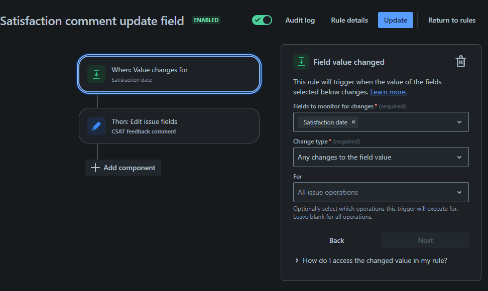

I have been running an automation rule for well over a year without any problems. However, I just noticed that it was silently failing around March this year.
Automation rule is set as this:

1. If this is "likely what happened", then what changed in March/April? The rule used to work fine and I don't think users en masse started to have lag in their comment submit times.
2. The rule's trigger is/was set to "Any change to satisfaction date". I suspect an api changed and the satisfaction date (to the second) stopped updating and began only logging the initial upon star rating.

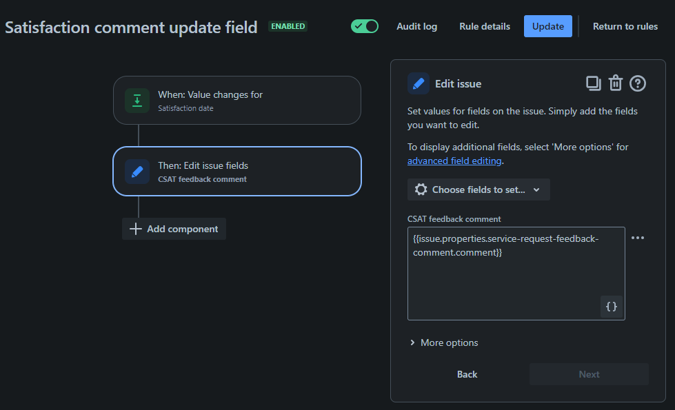

I was logging a ticket for this exact same issue! Stopped working since March 2024! While this suggested self-serv solution popped up.
i used an automation to read {{issue.properties.service-request-feedback-comment.comment}} and copy the comment into a custom field.

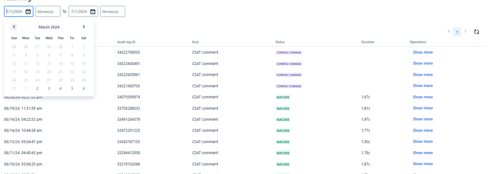

Since March 2024 it stopped working. Going back to search in the Audit Log doesnt offer me logs before April 2024. What happened?
The automation doesnt show it malfunctioned but it stopped working since March 2024.
apparently i cannot go further back than 3 months in the audit log, also in other automations.
what this always like that?
anyway, the automation stopped working since March 2024. I checked CSAT comments from Feb 2024 and before, and they where pasted into the custom field automatically without any issue.

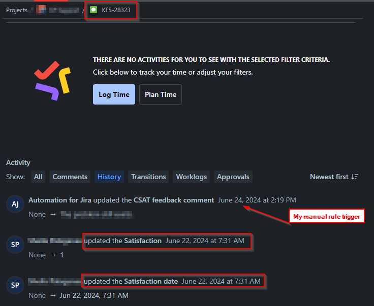

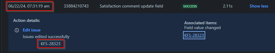

Hi @Yong Yang ,
The last screenshot shows the CSAT feedback comment field was updated two days later but from a manual trigger as noted in the screenshot.
The issue is that the rule that is triggered from Value Changed to Satisfaction Date does not update the feedback comment as it should, and used to.
The screenshot if the rule shows this trigger.
The screenshot of the log shows it thinks it was successful.
The screenshot of the issue history shows it did not update CSAT comment on June 22 when the rule ran.
