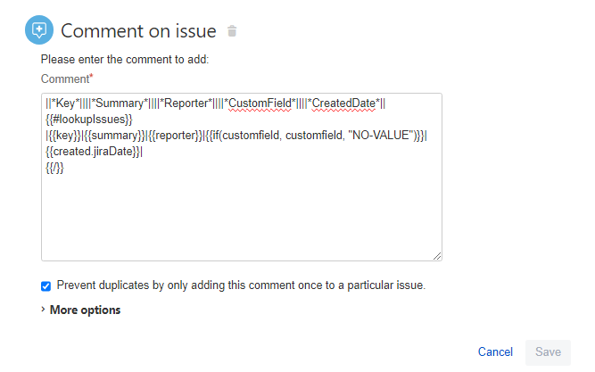

If you need, in your comment, a table of data from lookupissues, After your if condition, you can put below in your comment section (see screenshot below). Modify according to your fields.
||*Key*||||*Summary*||||*Reporter*||||*CustomField*||||*CreatedDate*||
{{#lookupIssues}}
|{{key}}|{{summary}}|{{reporter}}|{{if(customfield, customfield, "NO-VALUE")}}|{{created.jiraDate}}|

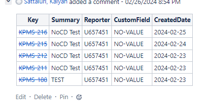

Gives below table in comment:
NOTE: field names are case sensitive.
Summary is wrong and will not give you data. summary is correct.
In my table I have a if condition to check if value is null, if so replaces with NO-VALUE.

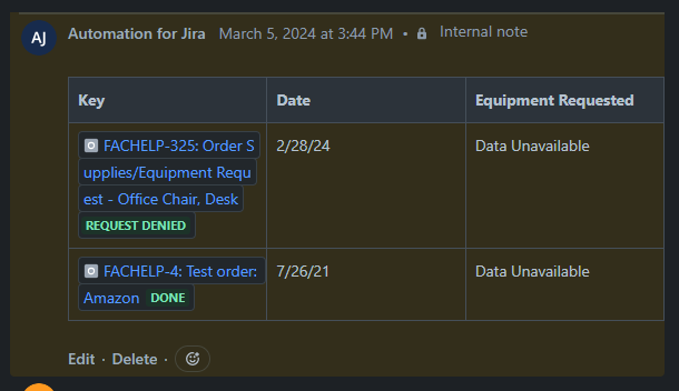

I was trying to anticipate how to use this new knowledge and updated the Comment action.
I tried it numerous different ways, but no combination seems to work. It still only returns "Data Unavailable" for all entries being pulled in my test. Issue 325 has values in those fields, confirmed with the earlier log actions, and issue 4 does not.
