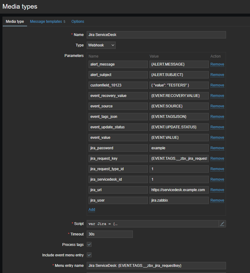

What happens is that for the non-working example, JIRA Zabbix errors out with what is listed below. The screenshot is from the Zabbix Action log. It is a problem with the formatting of the value because JIRA sees it as part of an array.
In the Media Type, for the custom field, I have tried the following formats (the IDs are correct):
TESTERS
"TESTERS"
{TESTERS}
{ TESTERS }
{"TESTERS"}
{ "TESTERS" }
{ "value": "TESTERS" }
{ "id": 10112 }
[{ "value": "TESTERS" }]
[{ "id": 10112 }]

I was not able to get custom fields to work within the Media types in Zabbix. I think that this is because Zabbix does not support certain symbols in the fields.
As a work around, I just wrote a script to do a curl and placed it in /usr/lib/zabbix/alertscripts on the Zabbix server.
Then, I have an action in Zabbix that calls the script from Administration -> Scripts -> JSD (the script is /usr/lib/zabbix/alertscripts/JSD/jsd.sh).
Part of the format in the script looks like this (variables defined earlier in the script):
-d '{
"serviceDeskId": "1",
"requestTypeId": "2",
"requestFieldValues": {
"summary": "'"$jsd_summary"'",
"description": "'"$jsd_problem \n $jsd_start \n Host: $jsd_host \n $jsd_severity \n \n Please assign to the proper owner for remediation. \n"'",
"customfield_10901": {"value":"Support","id":"10400","disabled":false},
"customfield_10301": "noreply@server.com",
"customfield_10309": "user.id"
