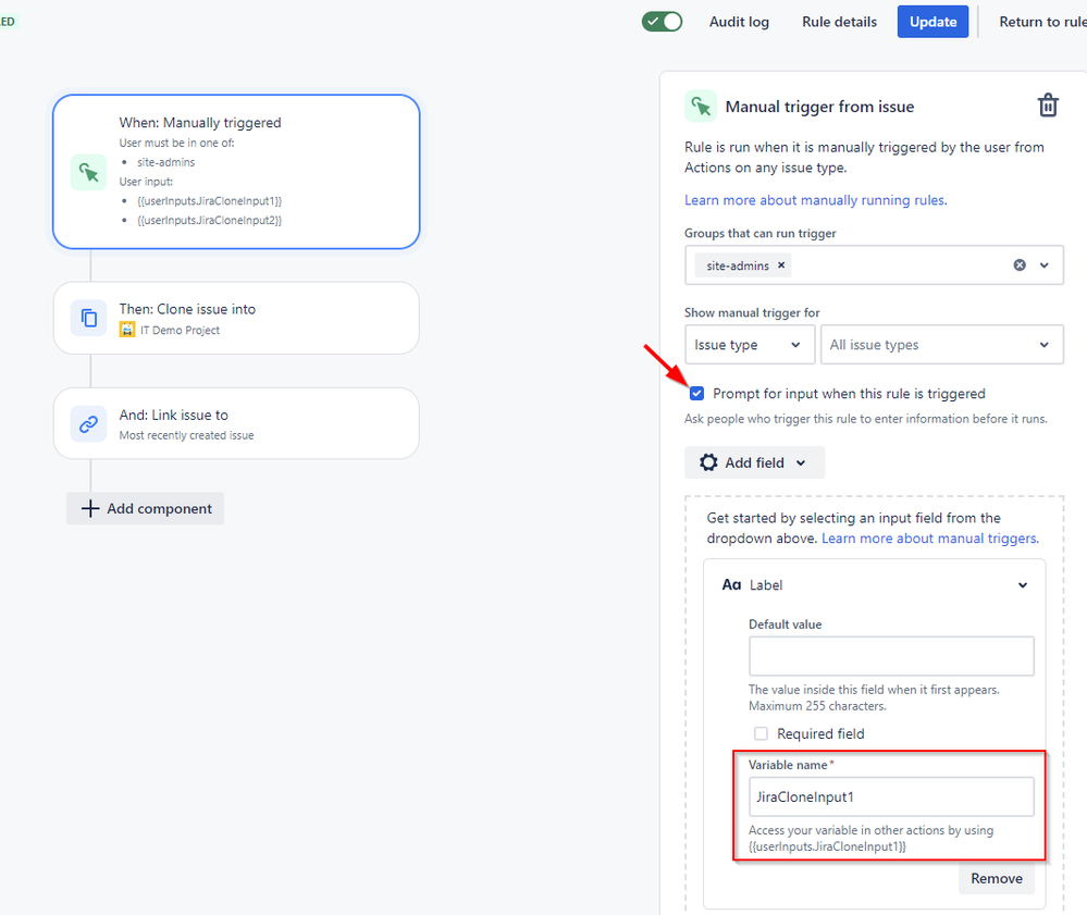

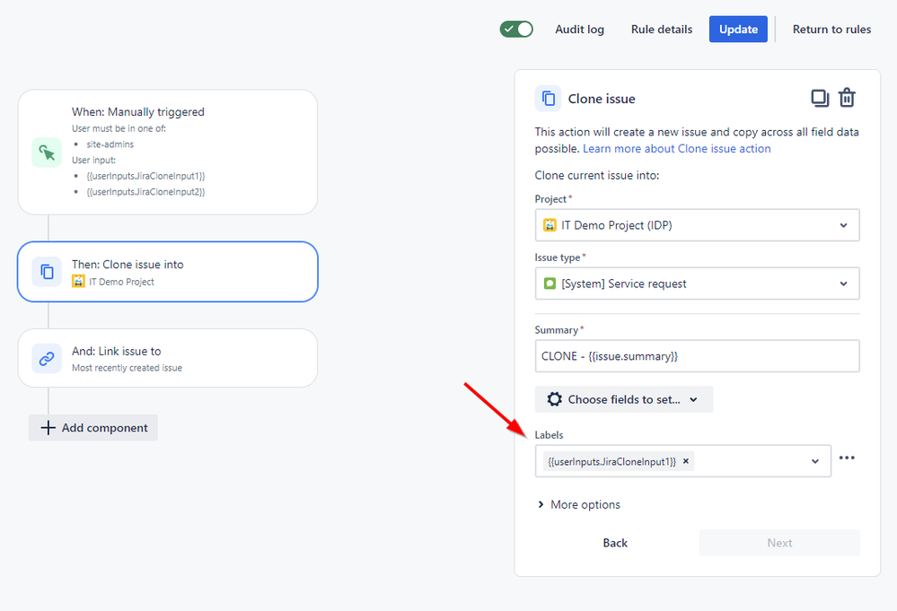

I have successfully cloned an issue using the action trigger in Jira Automation, and also linked the cloned issue from where it was created. This way I am able to preserve more field values than using the regular "create linked issue".
My issue now is that the request types are different and I need to set the request type. I want to set the new request type based on input variable using "Prompt for input when this rule is triggered".
I am having trouble finding the correct action to do this or can it be done even?

There is an option to prompt for input and I have successfully manage to set the label for example on the cloned issue based on user input.
What I need to do is set the request type since the request type does not match in the other JSM project
