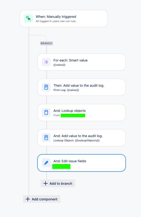

Luka Urushadze August 14, 2024
Here's the automation currently:
