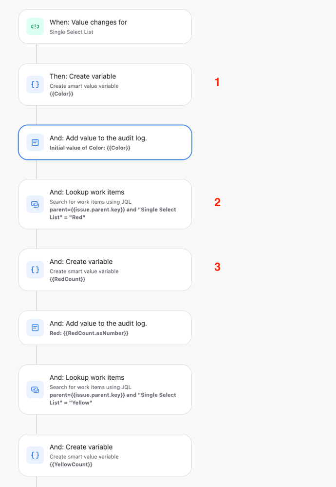

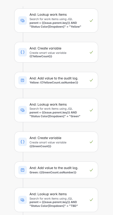

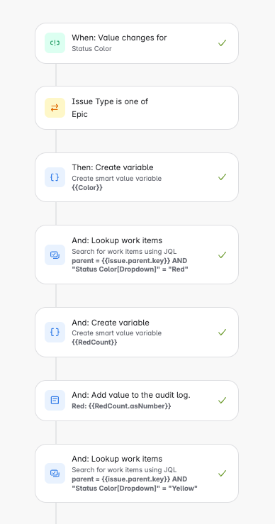

First I'm going to paste the complete rule. You'll see numbers in it for which I will provide details below.
There are lots of "Add value to the audit log" (Log actions) in it that I added to help with debugging. Ultimately those are not needed.
Screenshot 2025-05-08 at 10.54.28 AM.pngScreenshot 2025-05-08 at 10.55.57 AM.png
Trudy Claspill
May 8, 2025

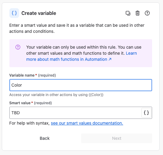

1. Create a variable that will store the Color you will eventually set in the parent. Set the variable to one of the colors.

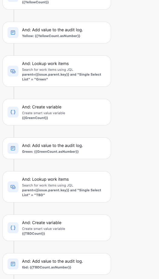

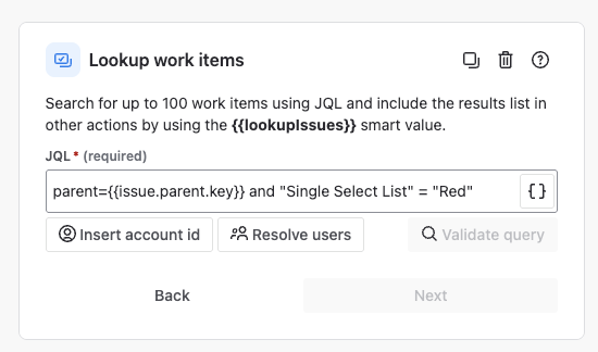

2. Use Lookup Issues to look for any siblings (of the trigger issue) that match one of the color values. In my first action I am looking for siblings that are set to "Red"

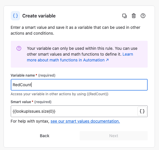

3. Create another variable to record the count of issues found by the Lookup.
Repeat 2 and 3 for each color value.

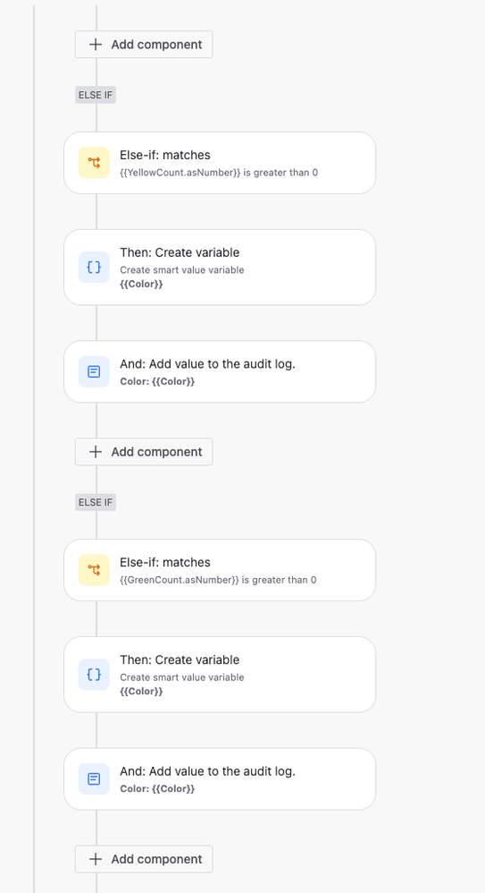

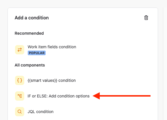

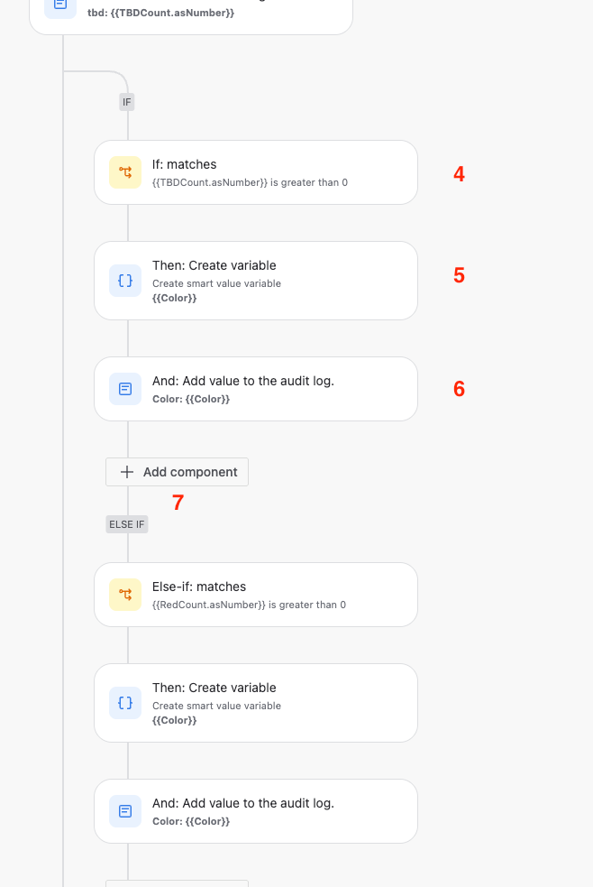

At 4 we start and IF / ELSE-IF block to evaluate each of the colorCount variables we created, and set the original Color variable accordingly. With the If/else block you order it based on the priorities of the color decision: TBD, Red, Yellow, Green.
First check if there were any TBD issues found, If so, set the Color variable to TBD.
There is no "Set Variable" action, so you use the Create Variable action again and specify the same variable name we used initially.
Make sure that you choose the IF/Else condition, not the IF condition.

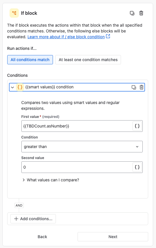

4. Check if any TBD issues were found
5. Set the Color variable to TBD if TBD issues were found.
6. Ignore 6. That is just a log action. I labeled that for call out by mistake.

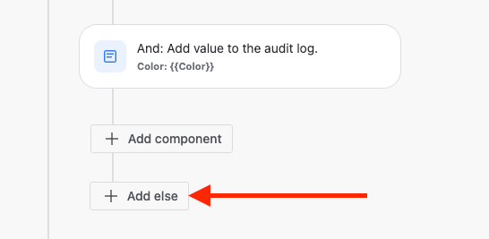

7. As you are constructing the rule, here you would see an option for Add Else. You will want to select that to put the next colorCount check into the rule.

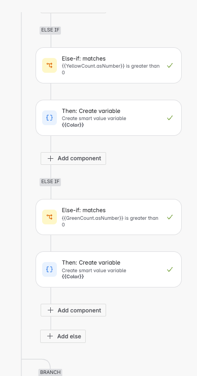

Click the Add Else button and repeat steps 4 and 5 for each colorCount variable. The logic proceeds to evaluating the Else-if blocks only if the preceding IF / Else-If condition was not met. So, if one issue was found with TBD, the Color variable will be set to TBD and none of the Else-if blocks will be evaluated. If there were no TBD issues, it will next check if there were any Red issues. If there were Red issues then the Color variable will be set to Red and none of the remaining Else-if blocks will be evaluated.

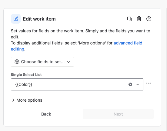

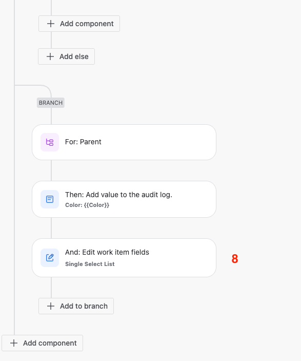

After all the IF/Else blocks are done you will then use the For Each branch to shift focus to the Parent of the trigger issue.
8. And here you set the color field in the parent issue to the value you have stored in the Color variable.

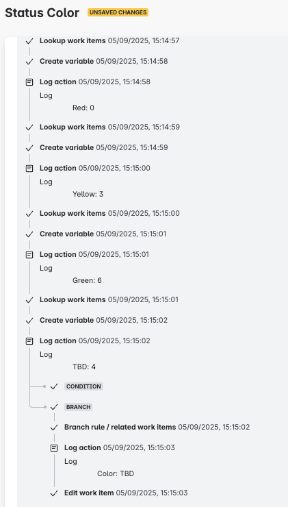

@Trudy Claspill  Thanks for the suggestions—I’ve configured it. I see that it’s checking all the status colors, but it’s not updating correctly. For example, if the child items has 6 tickets in Yellow, the parent should also update to Yellow, but instead it’s being set to TBD.Screenshot 2025-05-09 at 15.25.12.png
Sam Lin May 9, 2025
@Trudy Claspill  the automation ruleScreenshot 2025-05-09 at 15.34.38.pngScreenshot 2025-05-09 at 15.34.55.pngScreenshot 2025-05-09 at 15.35.04.pngScreenshot 2025-05-09 at 15.35.11.pngScreenshot 2025-05-09 at 15.35.18.png
Like Trudy Claspill likes this
Trudy Claspill
May 9, 2025
Excellent progress!
The IF/Else conditions are evaluated in order from top to bottom. The evaluations stop with the first one where the condition is met.
You have ordered the IF/Else evaluations like I did:
TBD
Red
Yellow
Green
So if there are any issues with TBD, then TBD is the color set in the parent. And there were issues set to TBD for the run of the rule you showed, so the parent color was set to TBD.
If that is not the correct, where should TBD be in the prioritized list of colors? It needs to be in the same position in the If/Else structure. If you want the color set to TBD only when there are no other actual colors in the child issues, then TBD needs to be in the last If/Else position.
