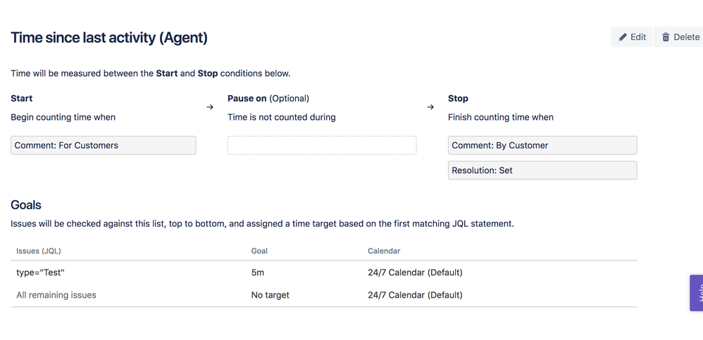

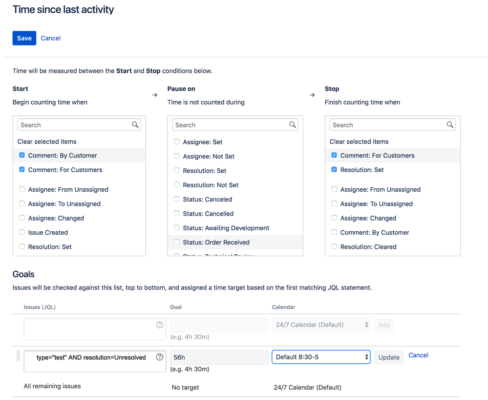

Hi all,
I have the SLA shown below. I am using this to run an automation that leaves a comment notifying agents when a customer hasn't heard from us in a week. As you can see I have the SLA start counting when the Customer or Agent comments, however, due to the SLA stopping the same way, they would have to comment twice for the timer to restart. Does anyone have any suggestions on how to rework this?

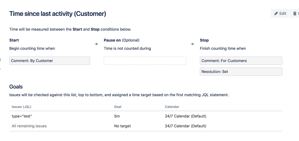

Hi Cody,
Indeed, when using the same start and stop the SLA may not work as expected because it's not clear when the SLA must start or stop.
As you must use the same condition to start and stop the SLA, the best option, in this case, is to create two SLAs, one for when your team is waiting for the customer's response and other for when the customer is waiting for a response of an agent.
This is the best way to know exactly how many time both customer and agents are waiting.
Then you can create an automation based on this SLAs to send a notification to agents.

Hey @Angélica Luz,
This is an incredible idea and it almost solves the issue.
The issue I am facing now is when the SLA is already counting. Let's say a customer has commented and the SLA is counting against the agent. When the agent responds, it obviously does not restart the clock. What do you recommend for this?

Hey @Angélica Luz,
I was able to achieve this the following way.
I created 3 SLA's
I also created 3 automations
When a customer comments on a ticket, the Agent2 SLA will start. The corresponding automation will wait for 1 week for the SLA to breach. Once it breaches, the automation checks for 1 thing.
Based on the assignee it will add an internal comment notifying the user.
When agent responds to the ticket, it will stop any of the above SLA's from running and start the Customer SLA. The above process will start over again.
Since I do not have Time to First response on all tickets, I had to create the Time Since Last Activity Agent SLA. This will start when a ticket without a First Response SLA is created. The same process above starts again.
