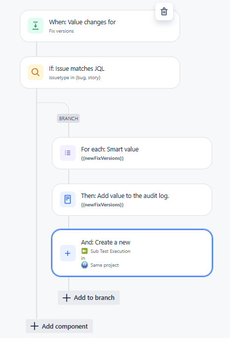

My rule
Main branch
Trigger: Value changes for the Fix version field.
If: JQL: issuetype in (bug, story)
Branch
For each Smart value: {{#changelog.fixversions}}{{toString}}{{/}} or {{#fieldChange.to}}{{fixVersions}}{{/}}, with Variable name: newFixVersions
Then: Create new Sub-task with Fix version: {{newFixVersions}} (and copying a bunch of other fields)

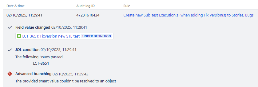

The problem
As noted I've tried using fieldchange as well as changelong but none of them work, at least not the way I want it to.
This is what I tried first and it doesn't work at all: "The provided smart value couldn't be resolved to an object".
Not quite right. It does read the changed Fix version field but goes on to create Sub-tasks for all Fix versions, i e already existing ones as well as the newly added ones.

Using the same setup as before I got the same results as with changelog: "The provided smart value couldn't be resolved to an object".
