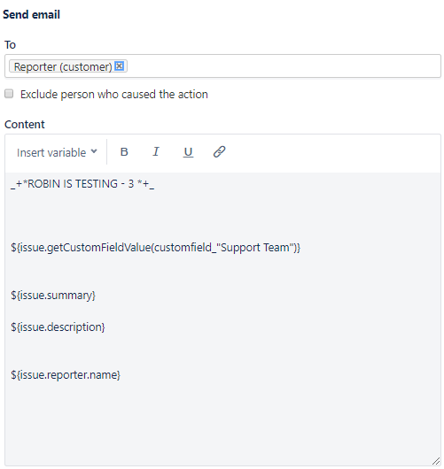

As a newbie, I am trying to include a variety of custom fields we created into a basic send email automation.
Under Automation on Jira Cloud
Trigger - Approval Completed
Then do this: Send Email to reporter (example - myself)
So the standard variables work
I don't have access to additional tools or plugins
Is there a simple way to pull in this custom field information
Support Team is the field name
The custom ID is 10051
Sample
Result

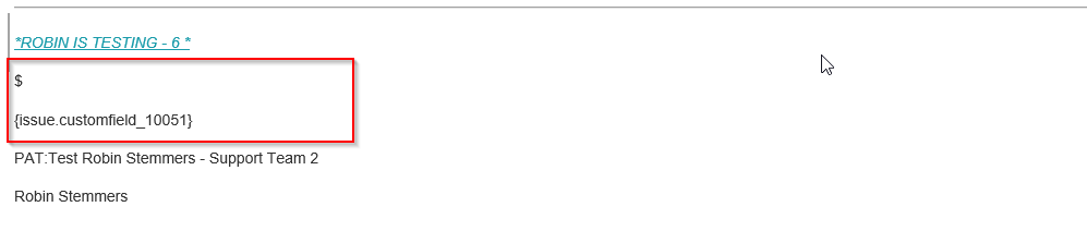

Hi Robin,
You may want to try ${issue.customfield_10051}. This may pull that information for you in the email.

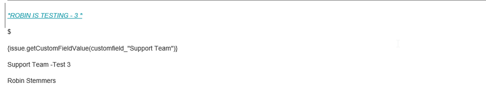

Hello Bryan
Thanks for the feedback. I have tried that before and it didn't work.
I tried it again now - incase i did something wrong - i still don't get the information
it appears as follows in my email
