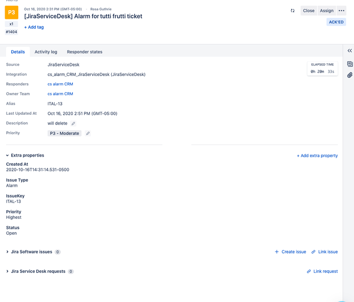

Here's what I see in OpsGenie after the webhook creates the alert (I do notice that there's no listed Jira Service Desk request listed at the bottom, but I don' t understand why, since JSD created the alert, and it should be linked, no?):

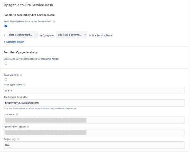

Here's the integration config (just the comment for now.. haven't added the next line since it's not working at all)

I also noticed you have changed the default issueKey extraProperty field to IssueKey (capital "I"), can you please change that back to issueKey in the integration's settings and give that a try?

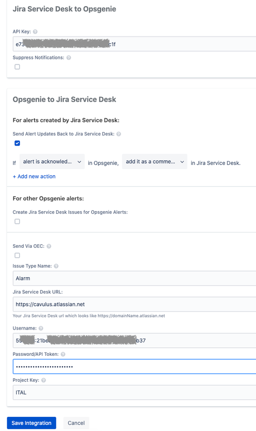

Thanks~ I just tried that change. But just received that same "Could not send / 401" error. Before I reach out to support, can you eyeball the screenshots below?
On the OpsGenie screen, is that the right user account ID format?

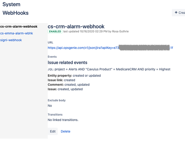

On the jira webhook screen, do I have the right config in the webhook?
JIRA webhook
@Rosa M Fossi You'll want to use your email address as the username - it looks like you may have some sort of userID there now. Otherwise the rest looks good :)
Hmmm~ I thought Atlassian no longer accepted emails as the user account name. I'll test that. If still no dice, it's time for a ticket to support!
Thanks fro all your assistance @Robert
That was it. The email address... how goofy of me! The documentation CLEARLY said email address, but I am so used to filling out userID's in JQL's since the change that I simply read it as "id" in my head.
