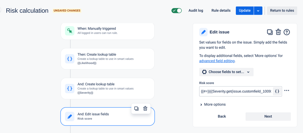

Once you have configured the two lookup tables, associating the numbers with the custom field options, we need to write the expression to do the product, in this case, of the Likelihood multiplied by the Severity.
{{#=}}{{Likelihood.get(issue.customfield_10090)}}*{{Severity.get(issue.customfield_10091)}}{{/}}
What we are doing here is to find the custom field values (using the custom field ID) from the issue and then replace it with the number from the lookup table and then to do the product, multiplying the first value for the second one.
In my case, I am using a manual trigger from the issue, but of course you could use any trigger for this, as long as the custom field values are populated, it should work.

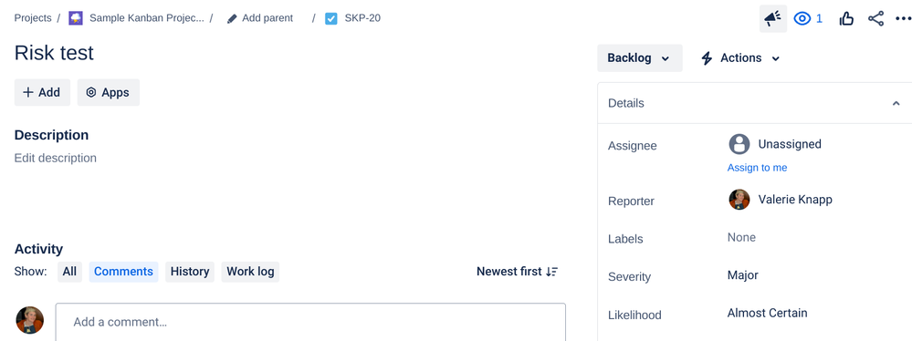

Let's do a test now. I have created an issue and populated the values in the custom fields of Likelihood and Severity.
And here we see the calculated score of Severity of Major (4) multiplied by Likelihood of Almost Certain (5).
