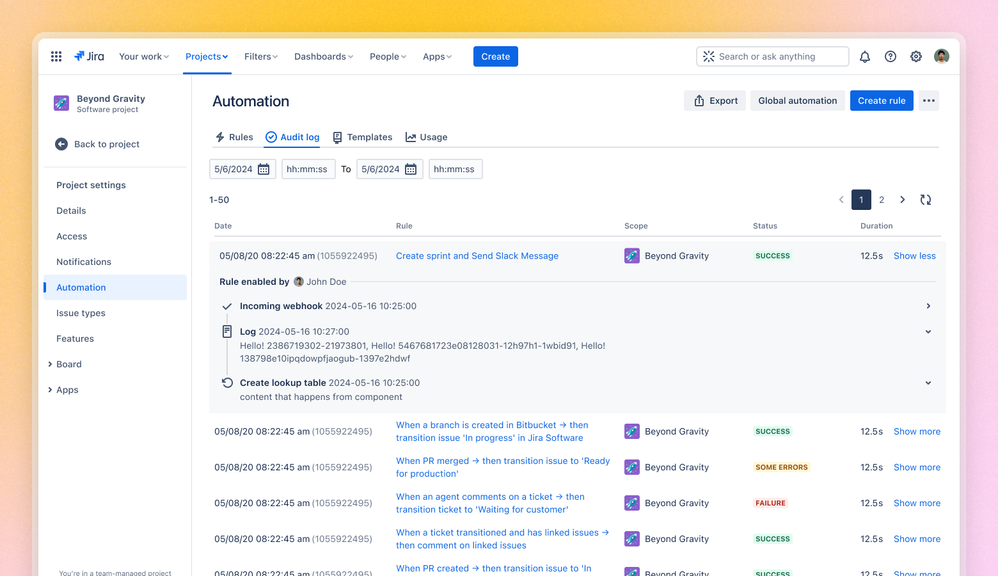

Tracking when rules are retried
Typically, when rule retry is working it will go unnoticed. However, you can view which rules are queued for retry and which have been successfully retried in the Audit Log. There are three statuses you may encounter:
Queued for retry - new status
When a rule stops due to a system error and is waiting or in the process of being retried, it will have the status queued for retry. To find out exactly where the rule stopped, click 'Show more' to view the component that stopped.
Successfully retried - existing status
If a rule was interrupted due to a system error and subsequently retried successfully, it will show the existing success status. When you click ‘show more’, the component that was retried will display a circular arrow icon instead of a check mark, indicating it was retried.
Retried and failed - existing status
If a rule stopped due to a system error, was retried but the rule ultimately failed, it will show the existing failure status and details in ‘show more’.
