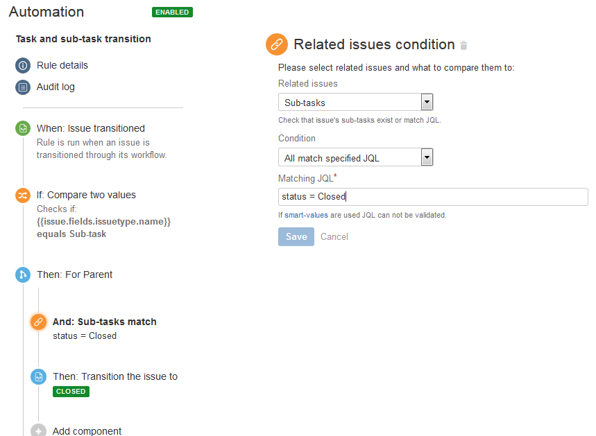

This is definitely possible using the related issues action and condition:
Lets break this rule down:
  • Trigger: When any issue in this project is transitioned
  • First check using the 'Compare' condition that it was a 'Sub-task'.  You could also use a JqlCondition here too.
  • Then: We use the related issues action to branch the rule for the 'Parent'
  • And on this branch we use the 'Related issues condition' to check that all sub-tasks of the parent match 'status = Done'
  • Finally if that condition is true, then the 'Transition Action' will transition the parent to 'Done'
Russ Watson-Thomas January 9, 2017
Hey Andreas,
Just expanding on this a little bit... I use multiple different subtask types. Is this powerful enough to differentiate? i.e. I can pick the subtask type I want to compare and then trigger a parent transition (and or do this via a filter searching for those subtaskIssueTypes())?
If so, that's incredibly powerful for me! smile
andreas
January 10, 2017
Hey Russ,
Yes you can certainly do more filtering.  We don't support else statements yet, so right now you'd have to setup multiple rules.
In the rule shown above you'd simply insert another condition before the "Then: For Parent" action.  You could use a JQL condition for example to test "type = myspecialsubtasktype" (or any JQL really). If the sub-task that was transitioned matches then the rule will continue and transition the parent.  If it doesn't then rule execution will stop.
You can also add more conditions in the "Then: For Parent" branch to for example only transition the parent if it is of a specific type/JQL match.
Setting up multiple rules is simple - you can just got to 'Create rule' -> 'Copy rule' to copy an existing rule if you just want to change the condition.  We'll add proper 'else' support in future but for now this should work as well.
If you can describe a more specific example I'm happy to provide an example rule as well.

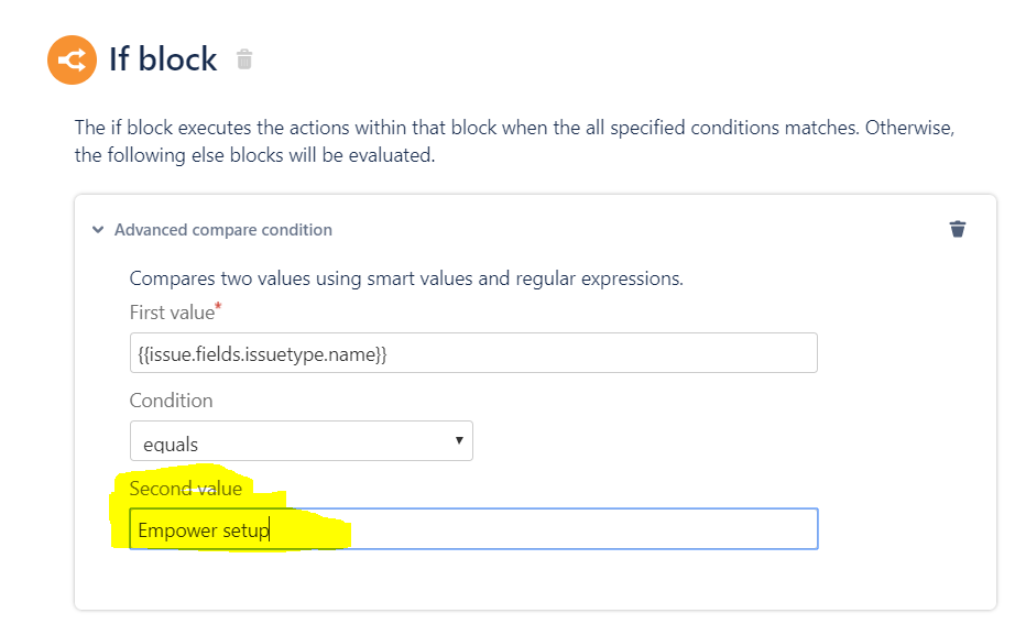

Can we include multiple subtasks inthe "Second value" option of the if condition?
My end goal is, when someone creates a issue and transition to a 1st status, it needs to create multiple subtasks,  and when all the subtasks are complete it should move to next status where another bunch of new tasks are created and when subtasks are closed again move to next status and so on.
I was successful in using automation for this and tested with one subtasks at one transition using this, but I would hate to create multiple conditions. I could use special string for all sub tasks and use contain option in if compare.
Just wanting to know what the best recommended approach/solution to achieve this.

Hi Guys,
I am trying to achieve the same thing in question with no success. Attached is the rule, I am not sure if I am doing it wrong because from the first screenshot which andreas posted, mine doesnt look same
1. I could not find compare 2 values option but mine just says match 2 option
2. It doesnt let me add a new action of the parent at the same root after I used if statement
I am not sure if anything has changed with regard to the version I am using.
