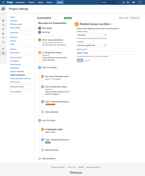

You can certainly do this with Automation for JIRA.  The rule is a little complex, but here's an example:
So lets break this down:
  • First we execute this rule whenever an issue is being transitioned
  • Next we check using a compare condition that the issue is a 'Sub-task'. We could have also used a JQL condition, but compare is a little faster to execute
  • The we branch of for the parent using the 'related issues' action
    • We now check with a 'Related issues condition' that some sub-tasks are "In Progress"
    • We also check with a compare condition that the parent issue is not currently "In Progress"
    • If those are true, then we transition the parent issue to "In Progress"
  • We have another branch point for the parent using the 'related issues' action
    • We check this time if all sub-tasks are "Done" using the 'Related issues condition'
    • If that's true, then we transition the parent to "Done"
The 2 'related issues' condition inside the two branch points, basically make sure the two branches are mutually exclusive and only one will ever execute.  Hope this makes sense!

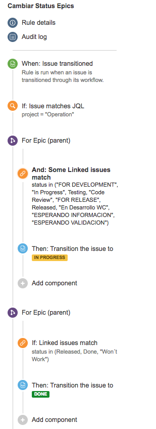

@andreas can´t make it work to transition Epic status based on Epic's linked issues status.
Any help is much appreciated.
Like Deleted user likes this
Sebastián Delmastro
October 16, 2017
@andreas any news on my question above?
Epics I want to transition are on "Operation" projects only.
Linked issues can be of any type (bug, task, story, incidents and subtasks) and from different projects "Web Crawling" and "Application" with same workflows statuses.
I have Global rule config and all are on create screen already.
I tried with this other rule not on an Epic but on any Task, Story, Incident or Bug to transition from one status to another depending on his linked issues statuses, but is not working.
I branch out for elseif conditions the "For Current Issue" to apply on different status for his linked issues.

Sebastián Delmastro
September 8, 2019
@Herbert Krippner  @Mark van Leeuwen

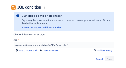

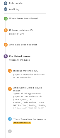

I work on a cloud version and this works fine for me:
We have a parent project called "Operation" and have several software factory related projects (Web, Data, Crawling, App) that transition the parent status issue based on their status issue.
(1) Rule must be global
If issue matches JQL transitioned is in any other project than the parent project "Operation" and is not an Epic (we use them on App, Web Crawling, Data, and others) then:
For Linked Issue (Types: can be "blocked", "is blocked by", "causes" relationships):
If: Issue matches JQL condition takes out the parent project and the "status" of the parent issue is going to be transitioned:
Based on some of the statuses of the related issues:
(for example, we change the parent status to "In Progress" if some related software factory issues transition to "QA", "Code Review", "In Progress", etc)

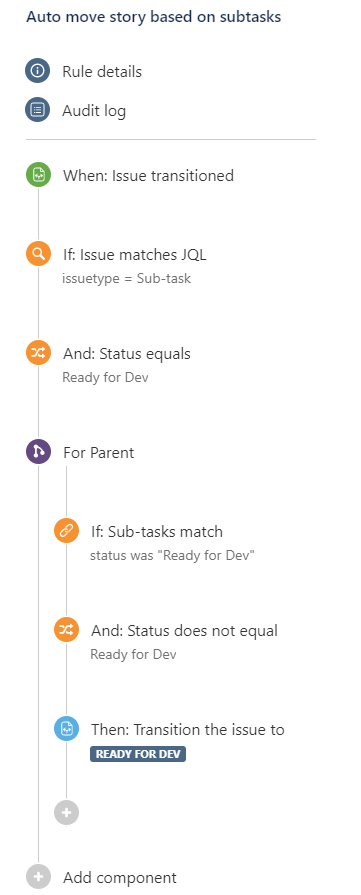

Hi @andreas , I am trying a rule in jira for which all sub tasks must be closed so that story can be closed.If at all any sub tasks are not closed the story cannot be closed. I tried the rule which is as follows.
Unfortunately the desired results were not shown. Can you tell me where did i do a mistake. Thanks in advance!

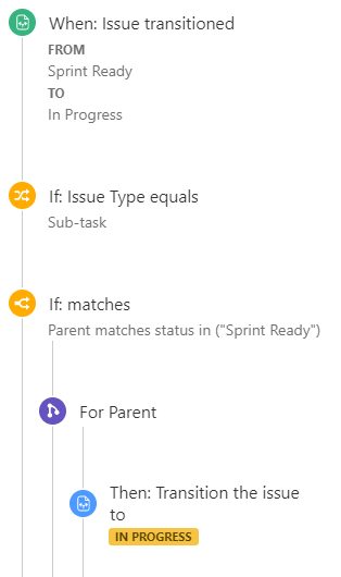

In current version of cloud we made it like below. For every transitions we have a copy of it

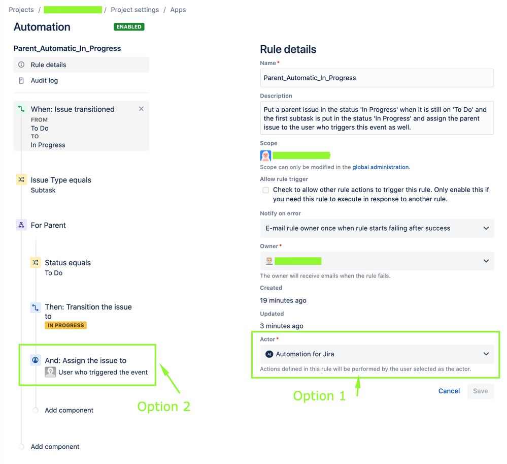

jeff_kehler May 28, 2020
I have a rule working to do this fine in Cloud, albeit a simpler approach as I only want to watch a single transition.
My teams tends to grab their subtask and get to work, forgetting to update that parent "Story" level status, which is all that really matters to the PMs (and myself) in most cases.
In simple English...
WHEN a subtask is transitioned from 'STATUS A' to 'STATUS B'
AND the PARENT is in 'STATUS A'
THEN TRANSITION PARENT to 'STATUS B'
The problem I am having is that the assignee of my parent story is being set to AUTOMATION FOR JIRA when this rule runs which was not part of my automation rule at all.
Is this an automatic function or something?
Any input is appreciated. This is only my second rule using automation for Jira Cloud.
Nico Hunink February 23, 2021
Hi jeff_kehler,
Thank you!! 😃
I hope you already have found the answer, but otherwise I have 2 options for you (in Jira Cloud):
  1. When you open your Rule in the list of rules you have in your automation space, you will see the 'Rule details'. In the bottom, you will find 'Actor*'. Here you can choose (at least at the moment I am writing this) for 'User who triggered the event'.
  2. Before I found option 1, I thought: it has to be possible that the user who triggered the event, should also be the assignee of the parent issue. So I added another action at the very end, so after the transition of the parent: 'Edit issue' > 'Assignee' as field of the issue and lastly > 'User who triggered the event'.
    Not that difficult in logic, but you have to find it and understand if first (I know I struggled to find my way around this in the next gen-project 😉 )
I really wanted to help you in this (if still applicable/necessary) because your screenshot helped me to set up my own rule. So thank you again for that! 🎉 👍
And although I am writing this at 5 AM in the morning (couldn't sleep), I am still genuinely grateful that you shared your ideas! Seems like a nice #hashtag to me '#genuinelygrateful' 😃
