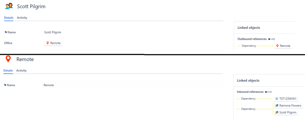

How it would work in asset for me, if I had set it up, would be that the Customer objects would have a reference field called "Region" and in that field I would add the Region object EMEA, which would be a "metadata" object.
Then updating the Customer's region to EMEA would automatically cause a dependency to the EMEA object.
