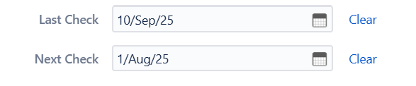

I want to create an automation in Assets, specifically: I have two date fields (Last Check and Next Check), and I want that if a date is entered in the Last Check field, the Next Check field automatically updates to +90 days based on the date in Last Check.

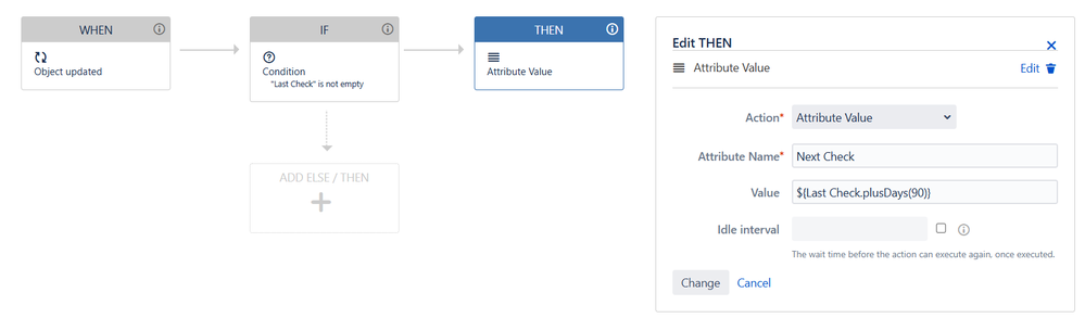

The problem is that the automation step "Then and Attribute Value and Value:" does not work with ${Last Check.plusDays(90)}.
But with a fixed date like 2025-10-15 or just ${Last Check}, it works fine.
As I understand it, my Assets instance does not support plusDays(90).
In the logs, it shows the error:rlabs-insight-attribute-3401: At least one value must be set;
Is there an alternative to ${Last Check.plusDays(90)}?
P.S. My instance is Data Center.

I attached 3 attachments where you can see the fields and the automation.
I would like to add that I also added other values in the automation (${Last Check.plusDays(90).format("yyyy-MM-dd")})  and ${Last Check.parseDate("dd/MM/yyyy").plusDays(90).format("yyyy-MM-dd")}
But without any result.
