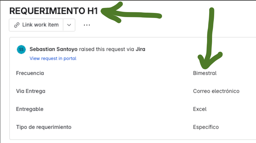

  • A screenshot of the linked Requirement, where the fields are properly filled

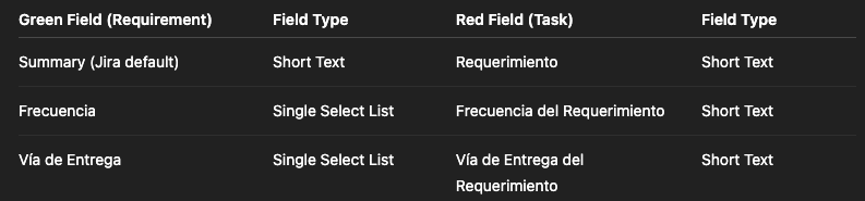

3. Here is the table showing the source and destination fields:

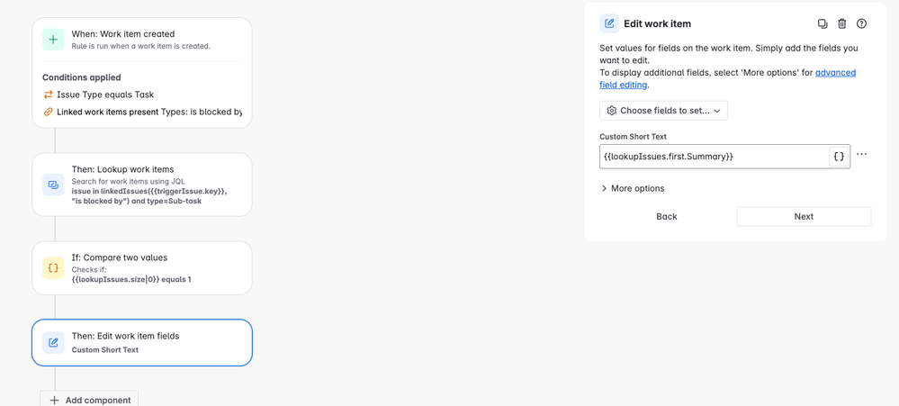

Can you confirm that you are linking the Requirement to the Tarea SC item within the Create dialog when creating the Tarea SC item? Or might you link the Requirement to the Tarea SC at a later time?

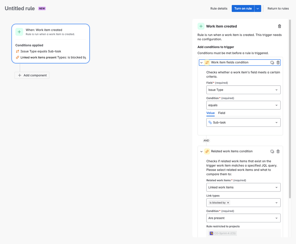

Here are my recommendations, assuming you are linking the two issues together within the Create dialog when creating the Tarea SC item.
With the Work Item Created trigger you can add directly to the trigger a check for the type of issue created and confirm that when it is created it has been linked to at least one other issue using a specified link type.

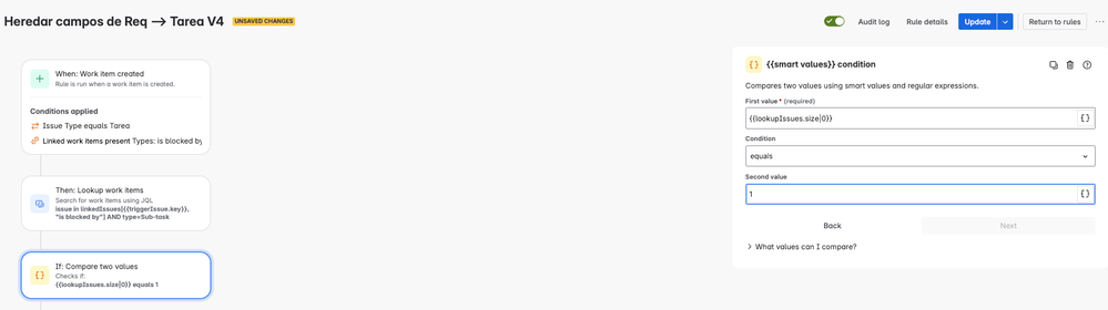

Next you would use the Lookup Work Items action to lookup the linked work items. Use the JQL you have already defined.

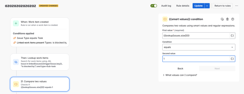

Add a condition to confirm that the Lookup action found exactly one item.

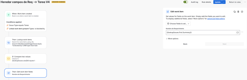

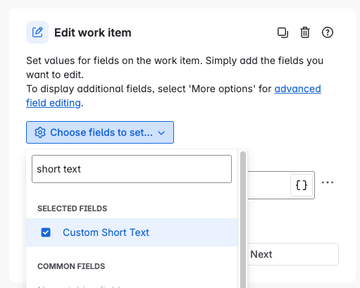

Use the Edit action to edit the issue that triggered the rule.
Select each of the fields you want to set. (I'm using a field name "Custom Short Text").
Into each field you want to copy information from a different field from the issue found in the Lookup action. We've already confirmed there is only one issue in the results of the Lookup action, so you can use "first" to reference that first/only issue within the results.
Do the same for each field, setting the value to {{lookupIssues.first.<name of field in green issue>}}
Note: If you needed to copy data from more than one linked issue, the rule would have to be different.

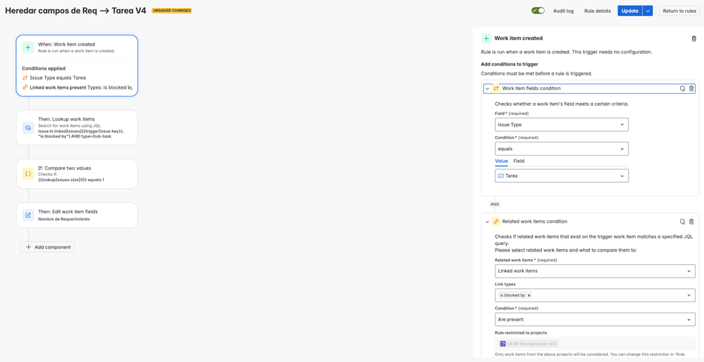

1. Trigger

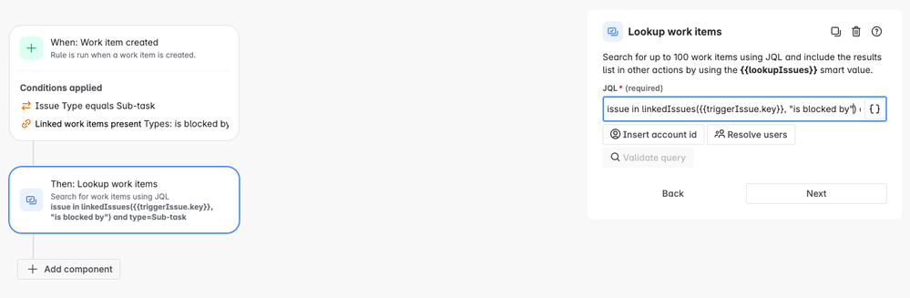

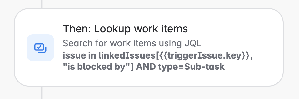

2. Lookup work items
issue in linkedIssues[{{triggerIssue.key}}, "is blocked by"] AND type=Sub-task
3. compare condition
4. edit work item fields (by now only Summary (Green) vs Nombre del Requerimiento (Red)
Note: No need to copy data from more than one linked issue, only one.
Trudy Claspill
July 14, 2025
Hello Sebastian,
You almost have it.
In step 2, the Lookup step, you need to use your JQL, not my JQL. In my JQL I used Sub-task for the type of item that would be linked. As you've mentioned in your post you are using Requerimiento as the type of item that is linked.
Additionally you have added square brackets around the parameters for linkedIssues. Those need to be parentheses.
I used "triggerIssue.key" rather than "issue.key" because "triggerIssue" is an explicit reference to the issue that triggered the rule. "issue" refers to the issue in context, and changes when you are using branches. I think it is a good practice to use "triggerIssue" when you definitely want to refer to the trigger issue.
issue in linkedIssues({{triggerIssue.key}},"is blocked by") and type=Requerimiento

1. The trigger, thanks to you Trudy

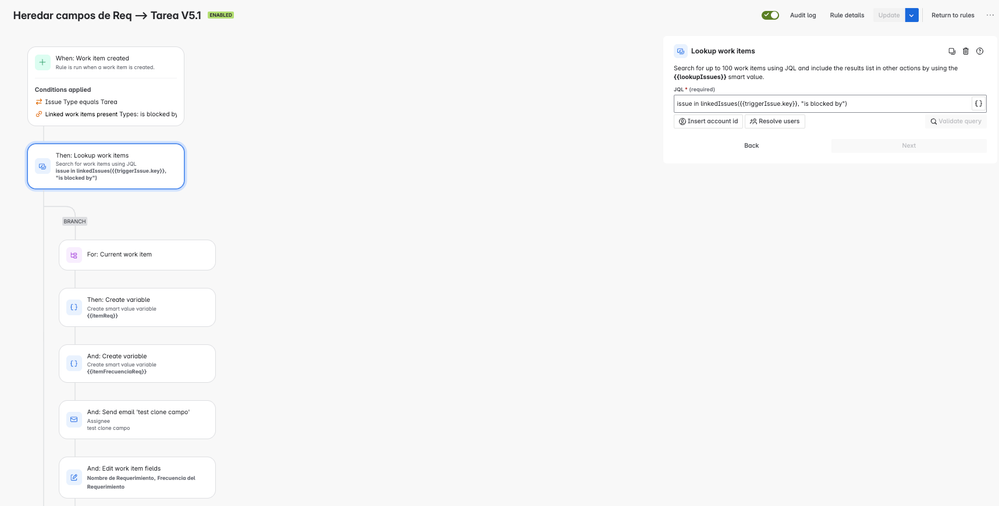

2. the Lookup you gave me with a minor adjustment
JQL:
issue in linkedIssues({{triggerIssue.key}}, "is blocked by")

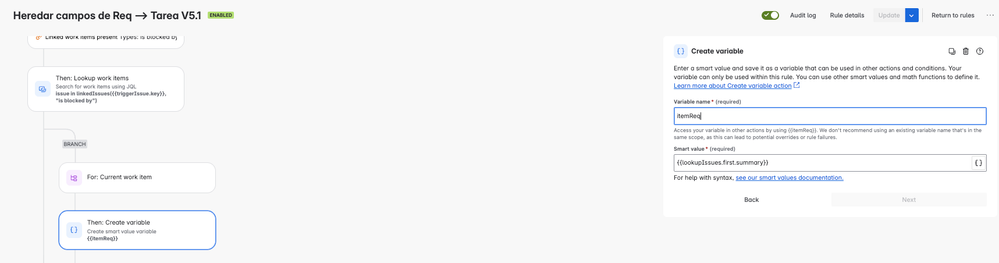

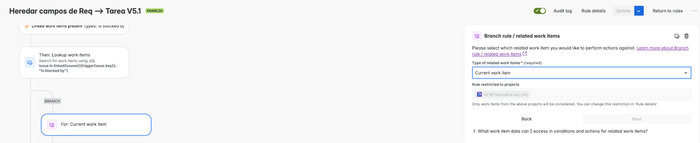

3. Branch rule / current work item

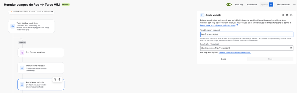

4.1 create variable summary
Variable name* (required): itemReq
Smart value* (required): {{lookupIssues.first.summary}}
4.2 same for the other variables
Variable name* (required): itemFrecuenciaReq
Smart value* (required): {{lookupIssues.first.Frecuencia}}
(disregard this email, was just to do some validations)

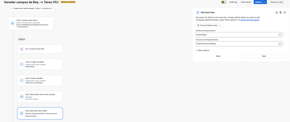

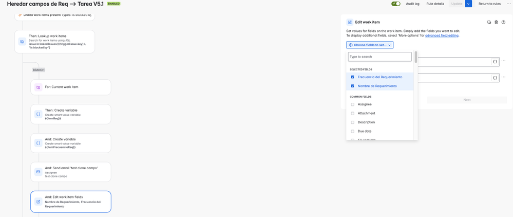

5. The Edit work item fields to modify the values of the fields in the new issue inheriting the values of the fields in the original issue
Nombre de Requerimiento: {{itemReq}}
Frecuencia del Requerimiento: {{itemFrecuenciaReq}}

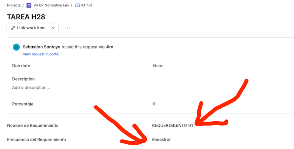

Result? SUCCESS FULL AUTOMATION
These were the original "GREEN" values
These are the replicated copied "RED" values

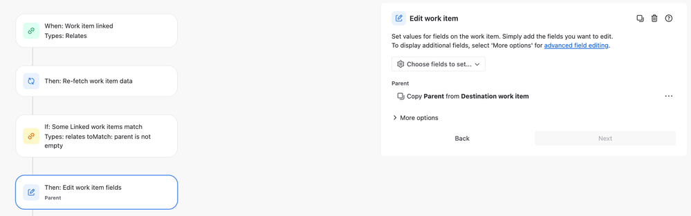

Walter Buggenhout
July 13, 2025
Hi @Sebastian Santoyo,
I may be mistaken, but if I understand your use case correctly, I have the impression that you are making things overly complex.
Assuming that you just want to copy values from a newly created work item from a linked work item from type requirement, you can use a smart value to refer to that specific requirement item to copy values from.
In your rule, you are trying to use a {{lookupIssues}} smart value, but:
  • if you want to do this, you would need to run a Lookup Issues action first in order to get data into that smart value (which you are not doing in your rule, so there's nothing to lookup from);
  • if you only have 1 item to copy the data from, there is no need to do a lookup via JQL
I have a sample rule in a test environment of mine that looks like this:
It uses the link to another item to determine where to get its source data from and the built in function Copy (field value) from destination work item to locate the linked work item as a source for the data.
It could be that you could simplify your copy logic very much in the same way to achieve your goal.
Hope this helps!
