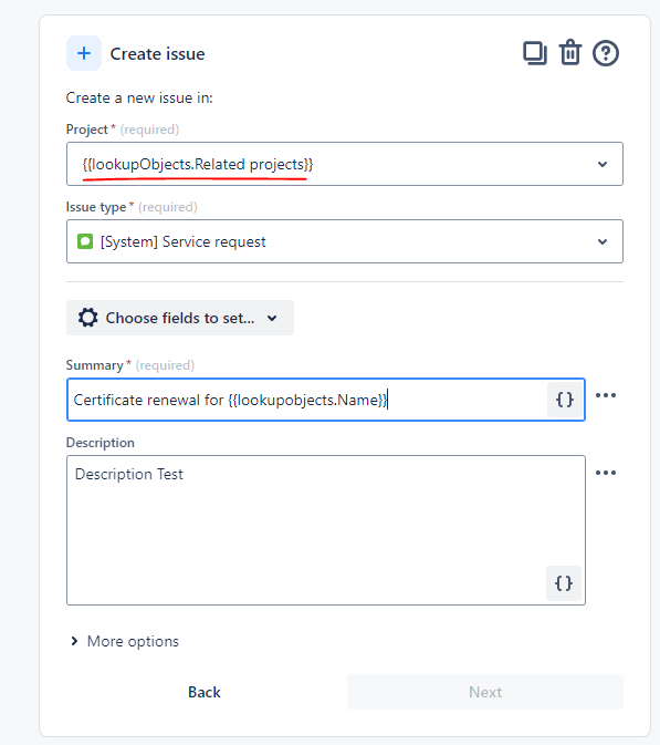

As I mentioned above, I am able to find the correct objects and get the information that I need, however I am unable to use the object smart values in order to create a ticket in the correct project (or to add some information from the object in the ticket for that matter).
I have this component:
When I run the rule, the smart value ({{lookupObjects.Related projects}}) finds the correct project but it is not recognized by the Create issue component.

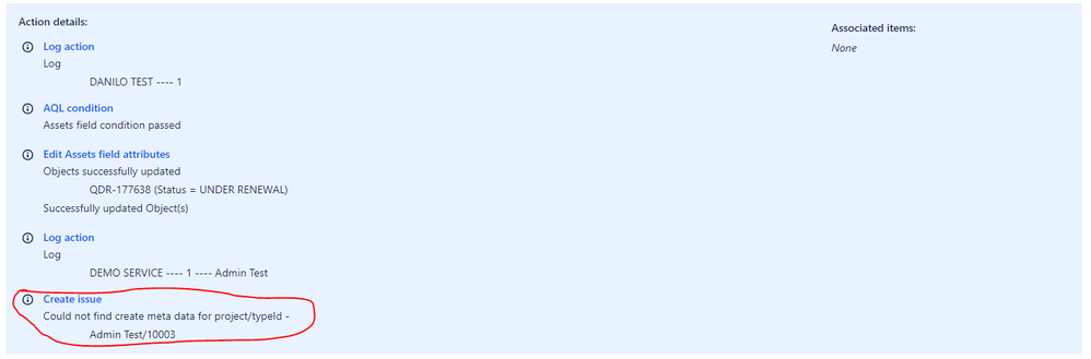

Here is a screenshot from the rule audit log:
As you can see, the smart value correctly found the project "Admin Test" but the component shows an error.

Kevin Patterson
July 11, 2024
Hi @Danilo Simic ,
Sure, happy to help. I've run into issues before programmatically creating issues in different projects with the Create Issue Action. First I would check your {{lookupObject.Related projects}} Is the value in this field the name of the project or the project ID? I believe the value the project field is looking for is the project ID and the asset object attribute you are sending it is the Project Name. You should be able to correct this by using {{lookupObjects.Related projects.key}}.

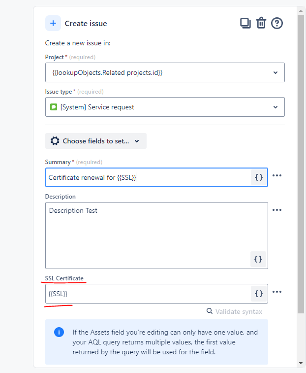

Hello @Kevin Patterson
{{lookupObject.Related projects.key}} did not work, but {{lookupObject.Related projects.id}} did work. So the component was looking for the project ID.

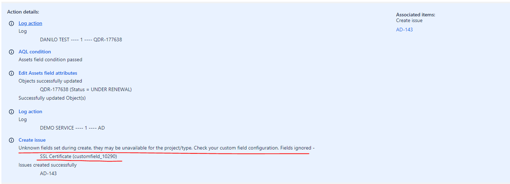

Final problem that I am struggling with. How can I use smart values to add the SSL Certificate object in an Asset custom field?
Here is an audit log screenshot of my last attempt:
The field is called "SSL Certificate", I have configured it as follows:
The field works as intended when I try to manually add a SSL Certificate object.
The smart values I tried to add were these (result was the same):
  1. {{lookupObjects.key}}
  2. {{lookupObjects.name}}
  3. {{lookupObjects}}

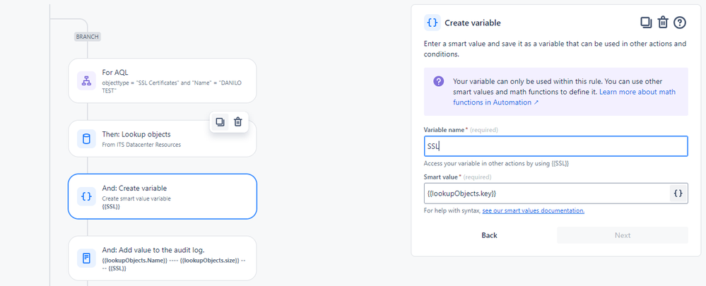

I did pay attention not to look at the Business Service, so in order to do this I created a variable which would save one of the 3 smart values I mentioned above.
If this is not possible I think I will have to use the Send web request component instead of the Create issue component.

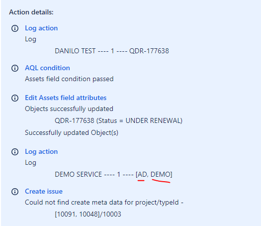

Apologies, one more problem that I forgot to mention.
If I have more than 1 related projects, how can I only pick the first one from the list?
In this case I have 2 related projects, AD (Admin Test) and DEMO (Demo project). Is it possible to somehow pick only the first one from the list?

I solved the problem with adding the object in an asset field during issue creation.
The smart values are ok. I was just being stupid with the screens. I added "SSL Certificates" fields in the request type but it never occurred to me to add it to the create screen of the relevant issue type.

Kevin Patterson
July 12, 2024
For your issue with multiple projects, you might be able to  retrieve the project you want with the get method.
I've used get to return a specific object in a list before, but i've never tried using it to retrieve a specific value from an list of attributes of the object. my best guess is the syntax will be something like this:
{{lookupObjects.Related projects.id.get(0)}}
Danilo Simic
July 15, 2024
Funny, {{lookupObjects.Related projects.id.get(0)}}  gets me the entire list.
While {{lookupObjects.Related projects.id.get(1)}} gets nothing.
I will try to figure it out. Please let me know if you have any other ideas. You have been of massive help, I do not thing I would have managed to do this much without you, thank you!
Danilo Simic
July 15, 2024
Ok, it is very stupid for some reason.
{{lookupObjects.first.Related projects.id.first}}
