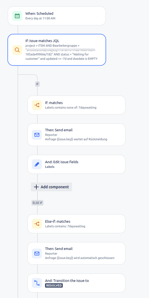

Brady Buttrey
November 18, 2024
Thank you! Does this automation rely on the label being set by another automation to work? Seems like you have something else setting a label to 7dayswaiting when it hits your time constraints.
Also I have attached what I have made based on yours to ensure I'm not missing a step without the conditionals.
Ralf Scheller
November 18, 2024
  • The first Action - after 7 days is sending the email and setting the label.
  • the condition "label is not set" is to provide a loop.
  • in the second run, another 7 days later, the condition is set, that the label is set and this action can be triggered.
  • Another autoamation deletes the Label, if any update on the issue is made.
Like Brady Buttrey likes this
Brady Buttrey
November 20, 2024
Quick question, doesn't this automation have steps that would reset the timer on updated. If you append a label after 7 of days in the IF statement, then it will not hit the else if to transition the issue because it had been updated with the label. You would then have to wait another 7 days, turning your total expiration timer to 14 days. Additionally, if agents are reaching out to users/customers, wouldn't that also reset the updated timer?
