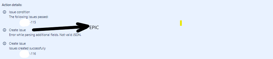

Have attempted to use "Parent link" however, an error has appeared.
However, when using this field in the automation, it worked
Based on your suggestion, how can I apply to a Story?
Even when I replicate the smart value suggested, the Story created in the automation was not linked to the Epic.

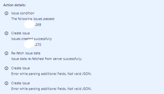

GeeLong February 14, 2024
@Joseph Chung Yin - on Jira it is indicated Epic Link will be deprecated and replaced by Parent based on the cloud version I am using. So using it might not work in the long run.
As suggested I have added "Re-fetch Issue data" and "Epic Link" in the advanced section, of which came up with an error.
Rule used for Story
