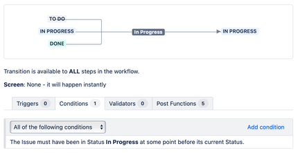

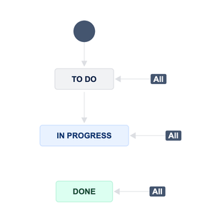

Are you sending Email This Issue notifications via workflow post functions? This seems like the easiest solution as you could tweak your workflow using two separate "In Progress" transitions.
For example, with the below workflow:
You could configure the following:
I don't have a Jira Data Center environment on hand, so my screenshots are from Jira Cloud, but you can apply a similar logic in Data Center using ScriptRunner's Checks if this Issue has Been in a Status Previously condition for example.
Hope this helps!
