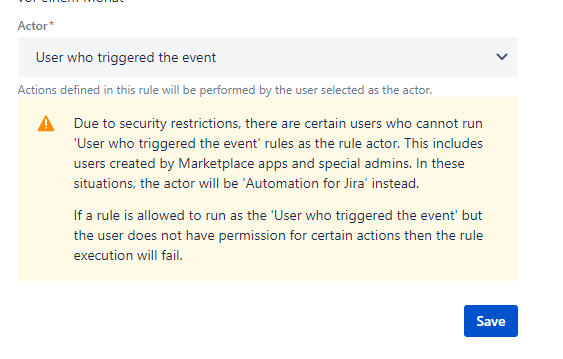

Hi @Support team -- welcome to the Atlassian Community,
by default the actor of an automation rule is the addon-user "Automation for jira" which means the actions will be processed with this user (eg. commenting, creating issue, reporter, etc...). This can be set in the automation rule details. This can also be set to "User who triggered the rule" (see screenshot) --> keep in mind that the needs sufficient rights to run the automation rule.
Hope this helps and solves your problem.

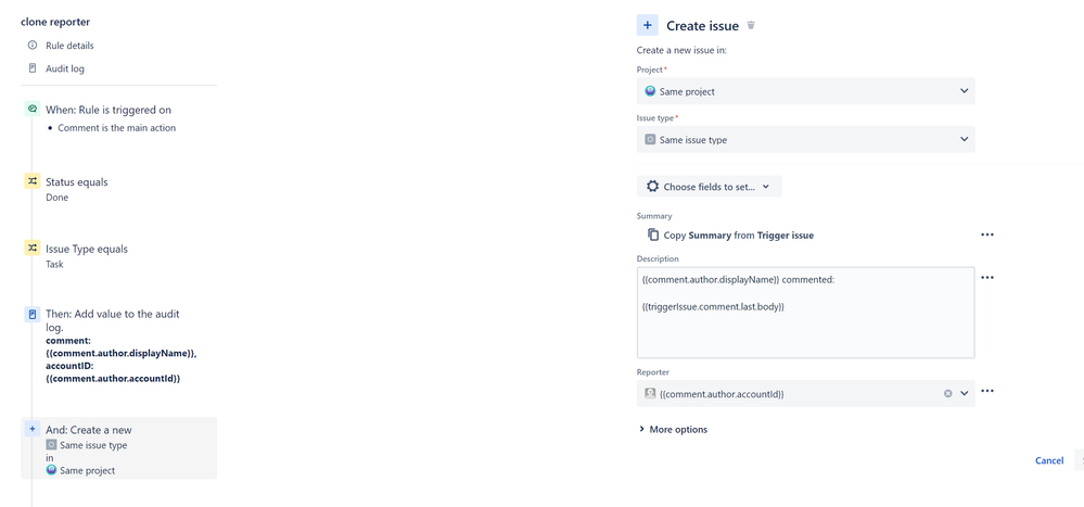

Furthermore regarding smart value:
In order to edit the reporter field it needs to be filled with the accoundID of the user (not the display name). Please don´t ask me why.....in my eyes this is very confusing =D (see following link):
https://support.atlassian.com/cloud-automation/docs/convert-usernames-to-account-ids/
I tried to kinda reproduce the behaviour (see screenshot):
