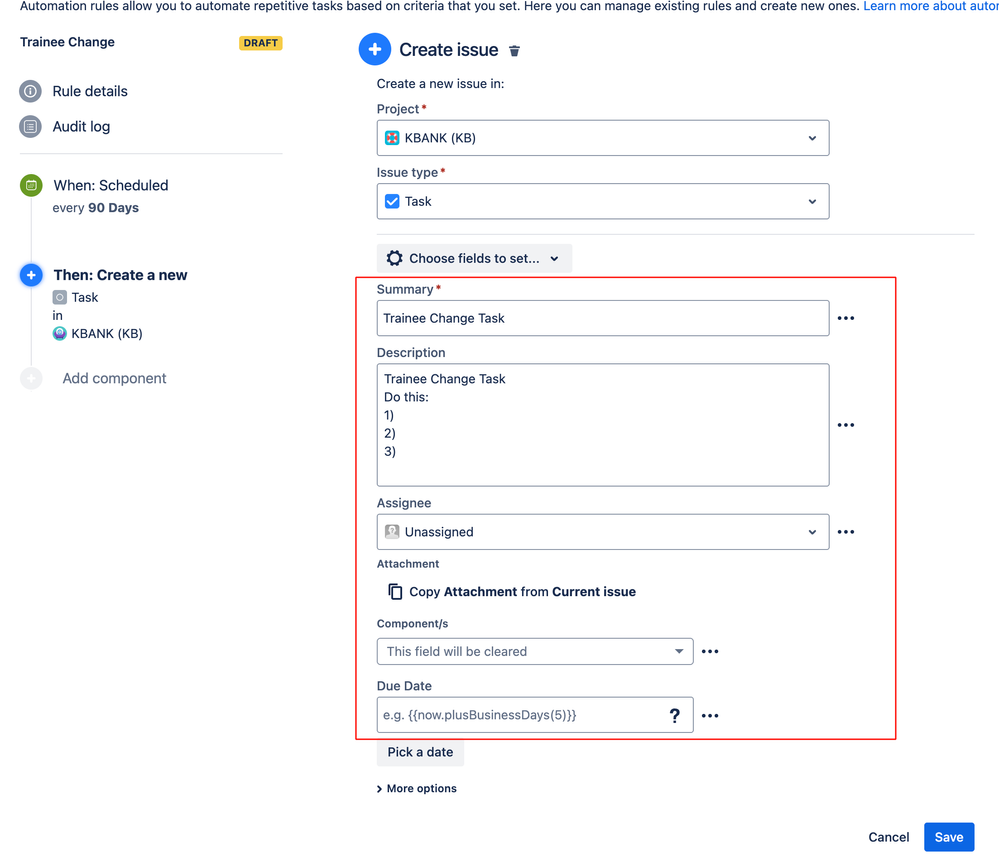

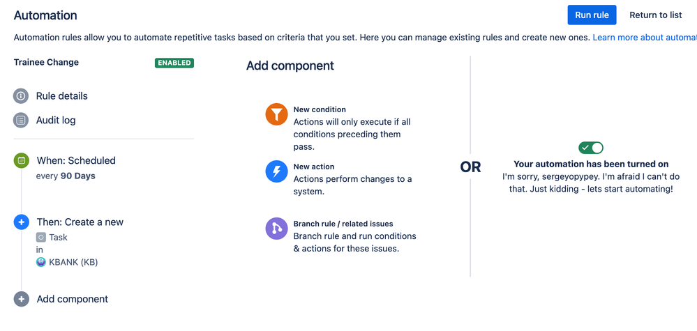

At first, you can set up periodic Automation, as shown in the screenshot below. Automation will create a preset task list every 3 months.
You can configure additional custom fields to set as well:

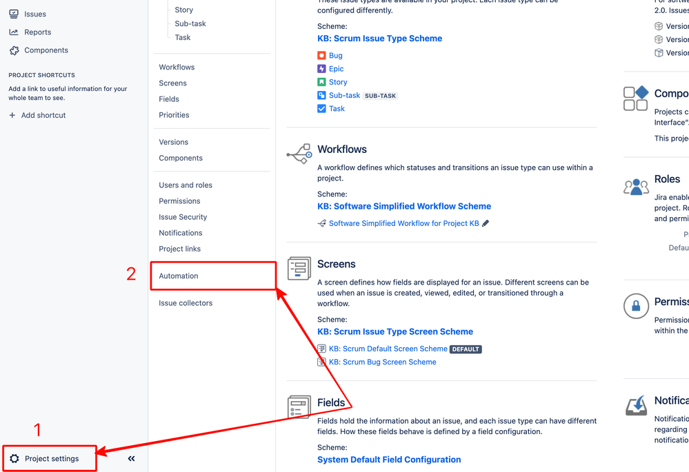

Do you have Automation for Jira? You can check this by clicking on Project Configuration (1) cog and looking for Automation section (2)
I have automation...that's not the problem.
I'm more looking for a solution on how exactly I could best implement this. Maybe there are good ideas in combination with forms, automations, scripts, etc.
