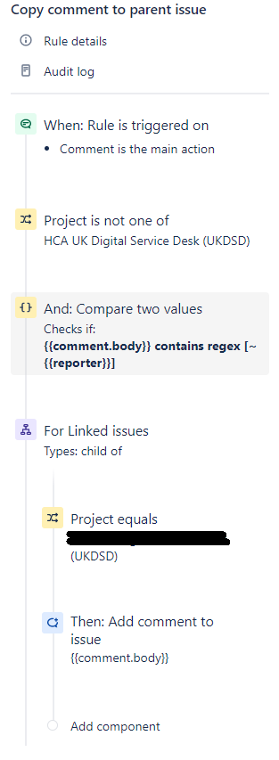

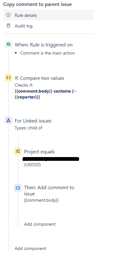

I'm trying to use JIRA automation to copy a comment from a child ticket to it's parent within another project based on the reporter of the child ticket being tagged in the trigger comment.
the audit log is stating there is an issue in the advanced compare condition although I have tried using a variety of ways of phrasing the {{reporter}} reference and don't seem to be getting anywhere with it.

do I get you right:
The condition would be that the reporter of the issue was tagged in the comment?
If so check for {{issue.reporter.accountId}} --> tagging in comments is done via accountID of the user. (see documentation here)
Hope I got your requirement right. Please let me know if this was helpful.
Best
Stefan
You are correct, after a bit more playing around I found that using regex as the comparison condition and {{reporter}} seems to give the result I was looking for as well.
Thanks for your help :)
