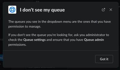

I saw this info box:
I'm curious if this is a different set of permissions than the project permissions, and if not, does anyone have any ideas why none of the other Project admins would be able to link our project to slack channels via Assist?

I posted a support ticket for this and got an amazingly quick answer from the Atlassian Support team.
What I had failed to look at was: <instance_name>.halp.com. Going to the "Halp" side of things I needed to configure the "queue" for my JSM project and promote the other project admins to be "Queue Admins". Once done, this allowed them to be able to link slack channels as request channels for our JSM project via the Atlassian Assist bot.
