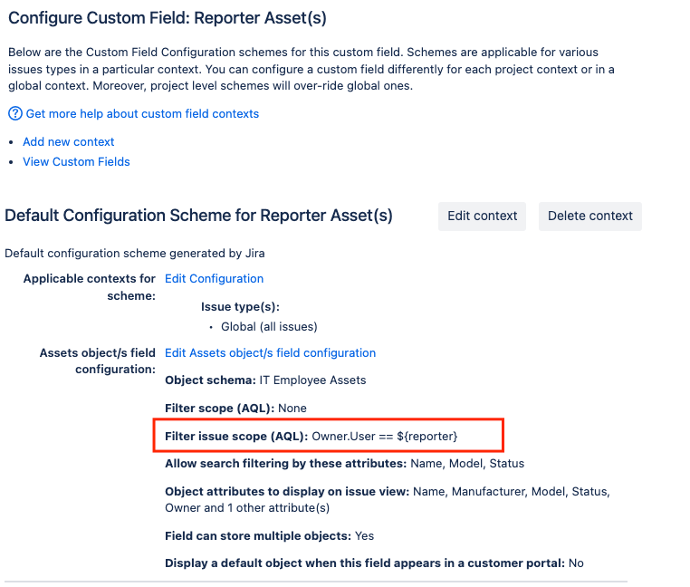

The filter scope of the "Report's Assets: Owner.User == ${reporter}

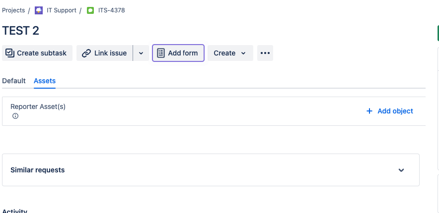

But I'm having the error "Lookup objects No objects found" which does not make sense to me, since in the issue view the field returns all objects correctly.

@Mariana Silveira SalesI guess that with your Filter issue Scope definition you don't need any rule, upon issue creation the Reporter Asset(s) should be filled automatically with thos from the issue reporter.
I assume Reporter Asset(s) has an attribute Owner that reference another object type that has a attribute User that is type User.

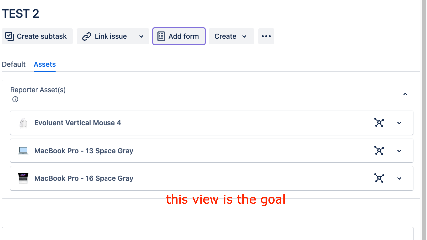

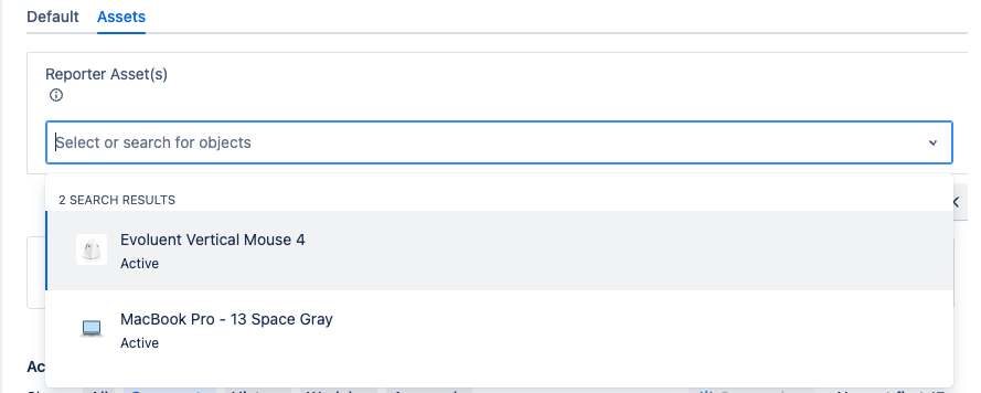

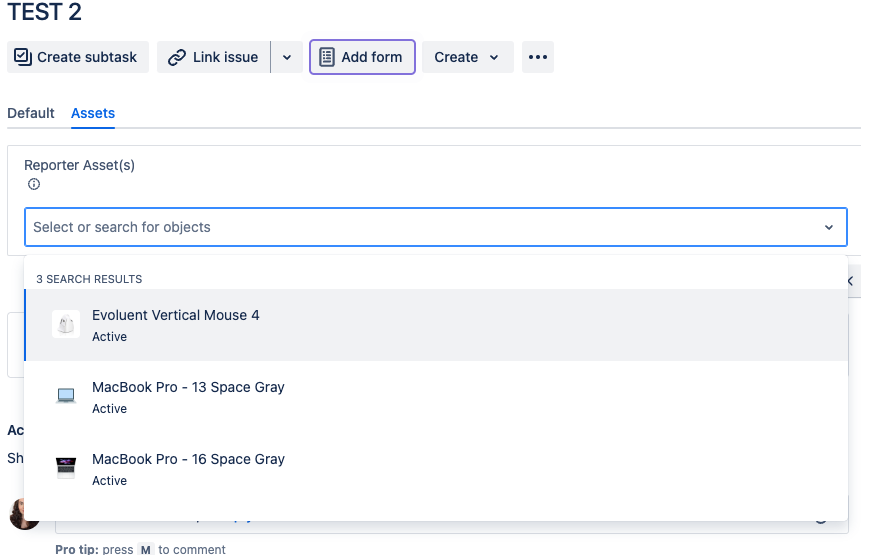

The field contains the correct objects from the issue reporter but it is showed as select list options in the field, so I can select or not.
I want that automation select all the objects for me, then the objects can be easily visualized in the issue view
