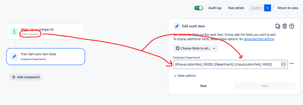

I believe this can be done, as long as the business owner is an attribute on the asset.
I'll provide an example of what I think you can use to pull the approver but in my case I just needed to pull the department.
So you will need a custom field tied to your application schema, and then when an application is linked to your service request you should be able to pull that business owner attribute using the method I use to get a customer's department above.
The issue.customfield will be the field on your service request that is used to link the application asset.
{{#issue.customfield_XXXX}} {{Business Owner Attribute Name}} {{/issue.customfield_XXXX}}
This can be used to edit your approvers field (or whichever field you have your approval workflow tied to)
Hopefully this helps, let me know if you have questions

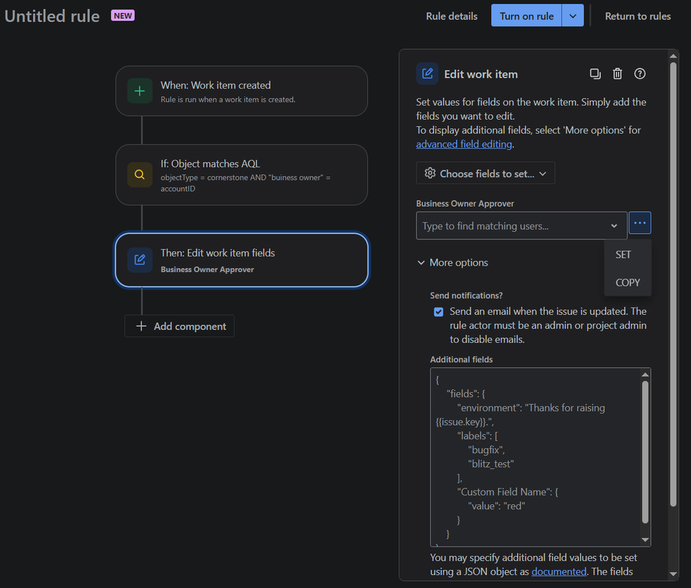

Thanks @Christopher Yen . With the recent update to Jira I don' see the option to use a JQL for the "Edit work item" option. This is where I am stuck. AddApproverAssets.png
Christopher Yen
May 6, 2025
Hi @Jesse Ortega Jr ,
If you type the smart values into the Business Owner Approver section I think it might prompt you with "Smart value [smart value that you entered into the box] " that you can select

Jesse Ortega Jr
May 6, 2025
  1. what type of project is this (e.g., company-managed, team-managed, etc.),
       ◘ It is a Jira Service Management project and company-managed.
  3. images showing the details of any relevant actions/conditions/branches.
       ◘ There are none
  4. images showing the Audit Log details for the rule execution.
       ◘ Rule has not been created so there are no logs.
  5. Explain where the issue is.
       ◘ The issue is trying to see how to update the custom field with the value from the Jira asset. There is no option to update the field using a JQL or AQL.
Thank you.

Hi @Jesse Ortega Jr
Add an action lookupobjects action in the automation rule.
  • Set the schema value to the schema where the applications are listed
  • Set the AQL to key = "{{customfield_xxxxx}} (customfield_Id of the CornerStone field)
So in the automation the Business Owner Approver field can be set using the smart value.
Use an edit action on the field Business Owner Approval.
  • smartvalue: {{lookupObjects.Business Owner.<attribute containing the Jira user>.accountId}}
As I see the Business Owner as a reference to an other object, is on that object a Jira user linked and in what attribute?
