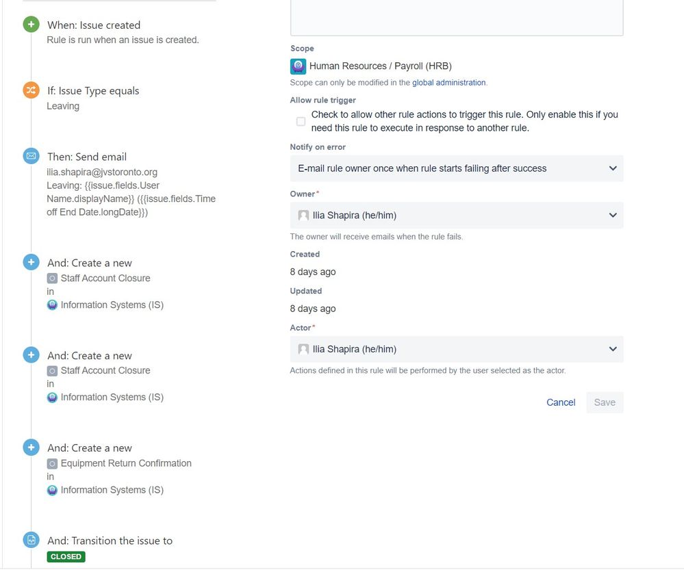

To further investigate the issue, can you please share a screenshot of your automation rules?
Marini
This is the rule

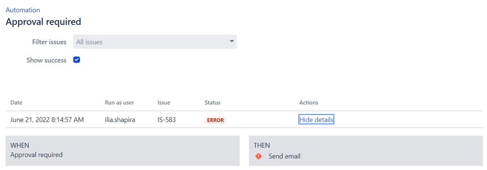

This is an error from Customer Notification Approvals log

If the IS-583 is created by the Automation Rule, I believe, if you click "Service project request" on the right-side menu, you will see "No match" for the Request Type field.
That's because, in your automation rule, you use Actions to "Create issue" where you won't be able to select the "Customer Request Type". By right, you should select Actions to "Create Service Management request" and select the correct Request Type.
If a JSM issue is created without a valid Request Type, the issue will not behave like a JSM Issue such as:
